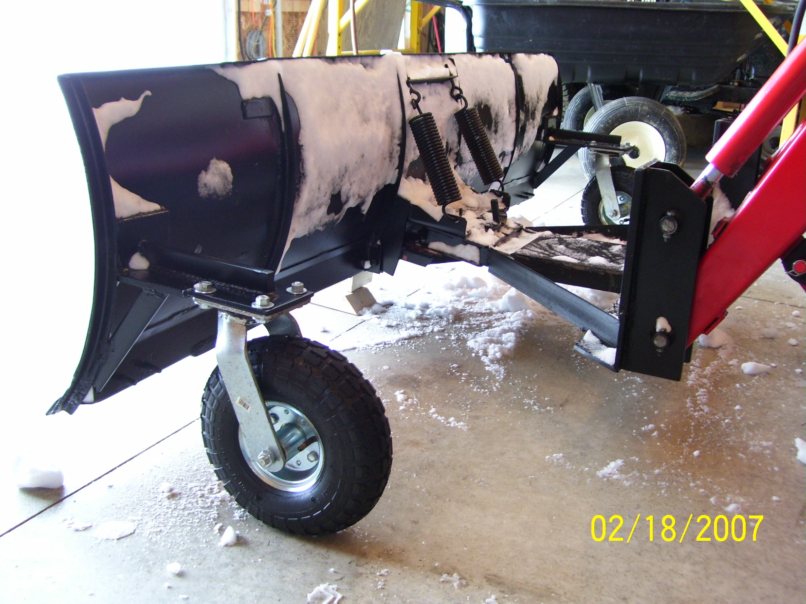

/ Adding Skid Shoes #16
This works much better on gravel than skids.
Those won't work at all in deep wet snow on gravel because they load up and slide. You'll never find any kind of wheels on any commercial plow for a good reason.
Why try to re-invent something that works well, is basically maintenance free and is cheap (skid shoes).
I've been using this snow blade for twenty years. The same skid shoes have been on the front for that long. I added the rear ones when I converted the blade to my tractor. Seeing I do pictures here are a few. The skid shoes cost me $23. each including the shoe,pin and washers.
The exact same design I have on my Lucknow. Those are (I believe) Meyers style skid shoes. I achieve my spacing by adding flat washers between the pad and the mount. Mine are going on 5 years of road work (I blow off the road between the farm and the paved road, about 1.5 miles) regularly.
Commercial plows tend to run Meyers style as well.
