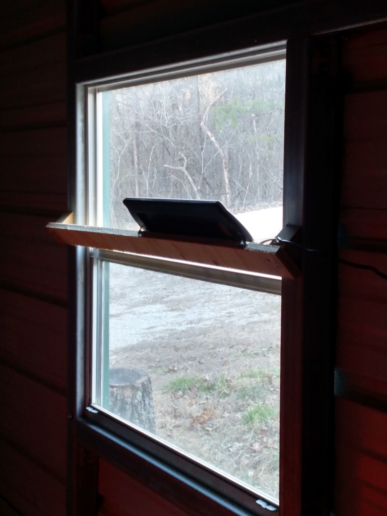

And here it is mounted in the window:

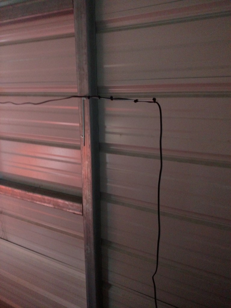

Here is the swingarm that keeps the wire positioned over closer to the wall.

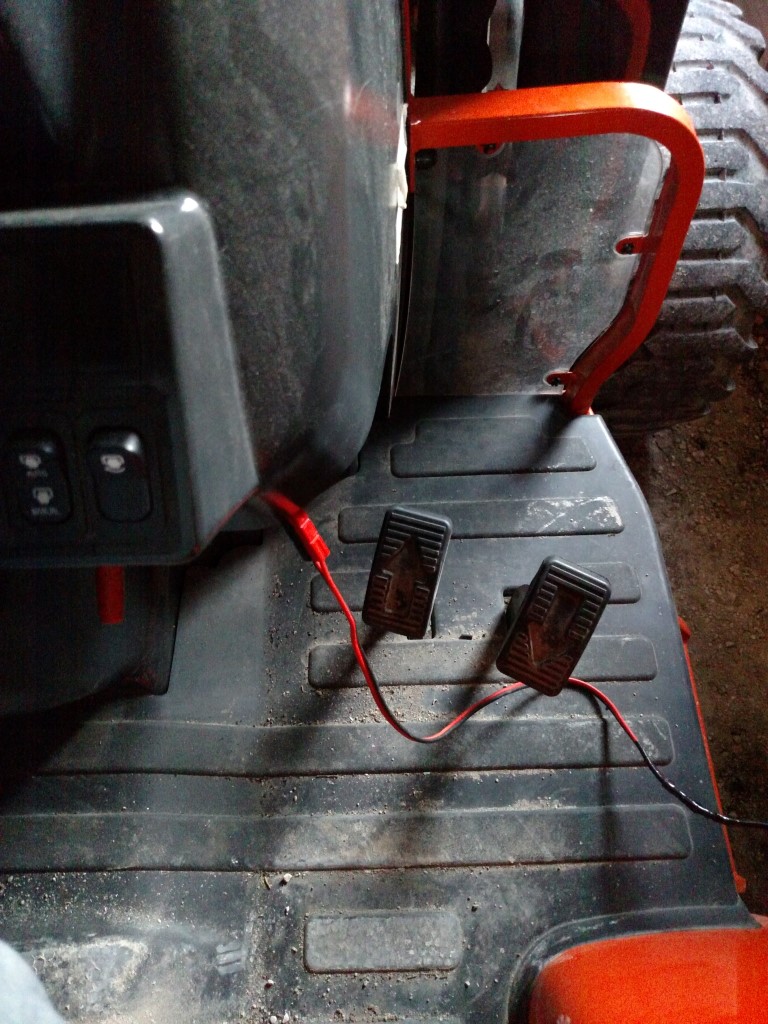

And here is that same swingarm with it swung over towards the tractor, ready to make connections.
And here we are all connected up.
Time will tell how effective it will be in keeping the battery float charged. I will take some voltage reading in a few days.
   / Adding Solar battery maintainer connectons.
#22
I took a reading today, it was cloudy and no direct sunlight on the photovoltaic cells. I read 12.62 volts on the battery. About what I would expect. Since the charger is so small and the battery so large, I would not expect to see much float voltage on the battery. It might float up some more on a sunny day. I will make another reading on a sunny day and see what happens.
