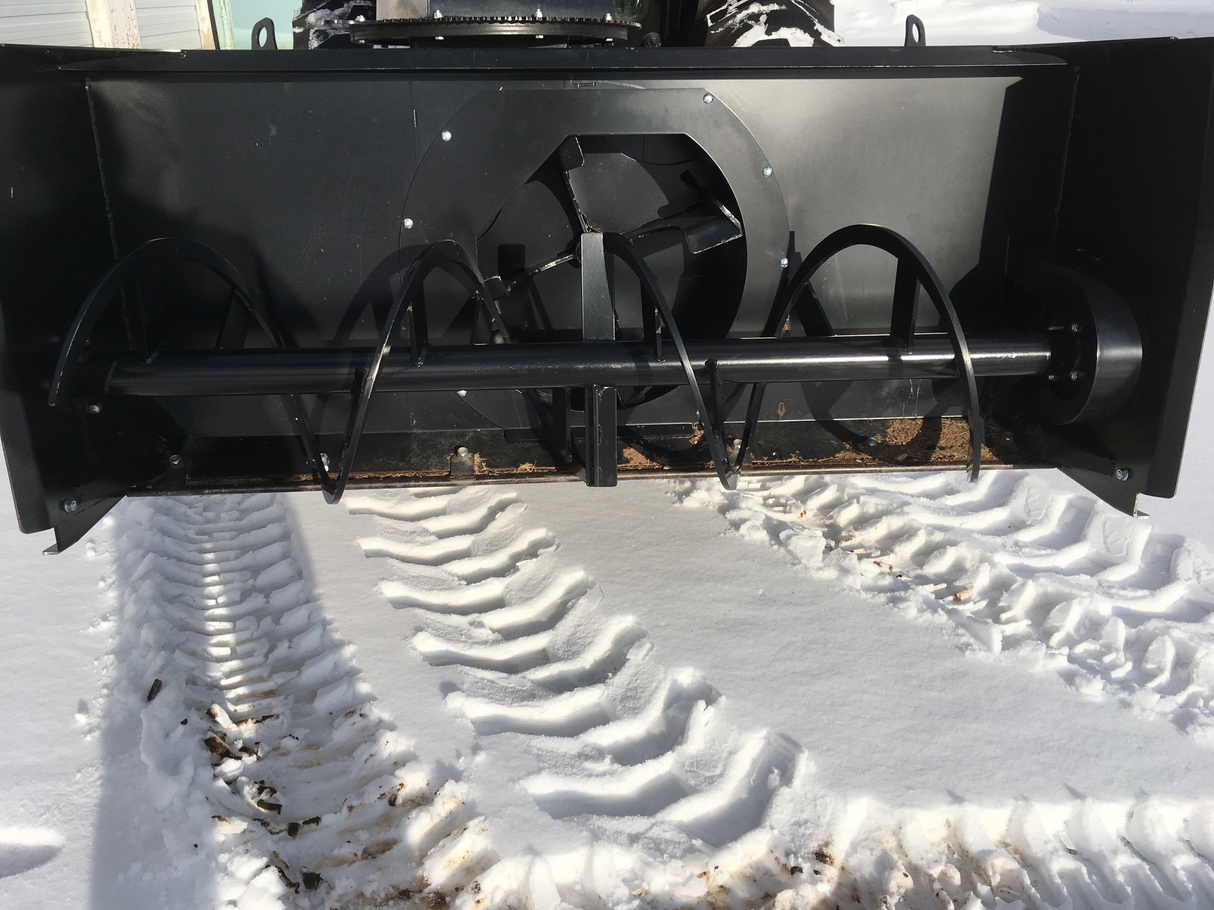

Anyone done this?
I sometimes use my rear facing 3PTH snowblower to blow back piles of snow but when they have gone through a thaw and freeze cycle, they're like cement and my smooth edge auger won't bite into the pile without a lot of effort (likely abusive to the blower too). So I'm thinking of welding on some triangular tabs along the edge of the auger to produce a serrated edge. Thinking this might make the auger bite into the frozen pile easier and then I could blow the bits away.

There are only 2 bearings on this blower. One on each end of the auger and they are cheap to replace too ($13 each). I think it would be easier on the bearings and the auger assembly if the auger could chew up the ice, rather than having the tractor force the auger into the piles.
There is a lot of room between the auger and the housing, to add tabs. So clearance is not an issue. Plus adding teeth would not weaken the auger, like cutting pieces out of it, would.

At times I have thought about adding the teeth to my auger, just too many other projects of a more important nature so I will be curious as to how yours works out.
This is all subject to change but my initial thoughts are to weld the two ends of 1/4" by 1" angle iron to the inner face of the auger, spaced 60 degrees apart. I have about 1-3/4 turns of the auger on each side of center so that will give me roughly about 10 teeth on each side. The 60 degree spacing should limit the number of teeth in the snow bank to 4 on each side at any given time which shouldn't add too much pressure on the auger/shear bolt and actually may reduce some of the pressure by providing a cutting action rather than a rubbing action. Placing the teeth on the auger surface facing the center should help apply force against the packed snow to help break up the packed snow better than placing them on the trailing surface. I haven't really decided on whether I would want to extend the teeth out beyond the auger diameter, I probably won't but I don't have a good feel yet on whether I should or shouldn't.
Here is a picture of my auger so maybe it will help you visualize what I am saying.
