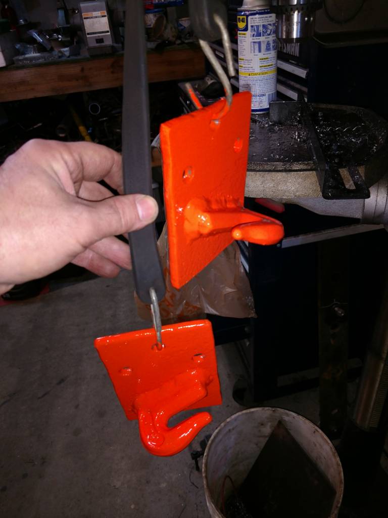

Actually I had it powder coated the black that matches the others stuff. I like it better then the blue actually.

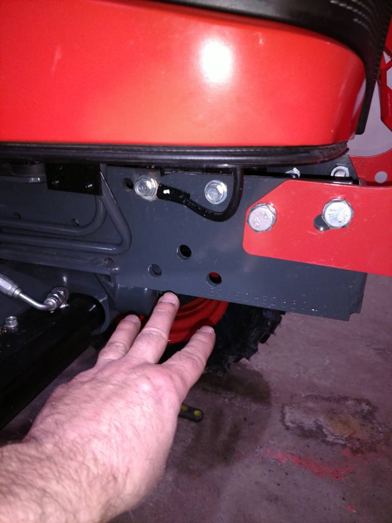

This is my solution to creating trailer tie down points on a B2650.
I was just thinking...if you drilled and internally threaded a shaft just long enough to be a snug fit between two black plates and threaded the bolts used to attach your hook plates into it, one on each side, it would add a lot of strength to it.
