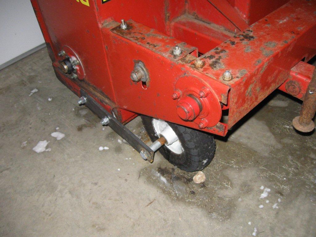

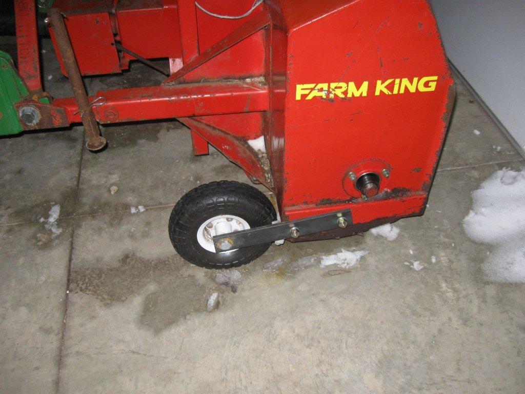

Added a set of the same $5 TSC tires to my Farm King blower yesterday afternoon. (I have a stockpile of those tires from various sales)
Anyway, this fall I had welded on some skids, which turned out to be ineffective on our large, loose, rolly-polly rocks on the driveway. Tried tacking on a piece of pipe/tube Saturday to help keep from trenching with the skids, no dice. Cut the skids off Sat night and built these wheel holders to replace them. Tried it out on a couple drifts that formed Saturday night, and it seems pretty promising. Found a few lumps in the driveway big enough to be scalped and toss stones, but overall a success. May need to reinforce the RH bracket or add a "dual" tire that'd sit outside the cut (not crazy about that w/o adding a wing or something to widen out the cut) since that side is a little heavier and I had to offset the tire to fit between the auger chain and the frame...

HuskerPlow, your blower looks a lot like my Kubota blower. They were probably made by the same manufacturer. If yours is like mine, the center of gravity is toward the cutting edge.
You might try shortening your top link to avoid the scalping.
Keep us posted on how the wheels work over time.
