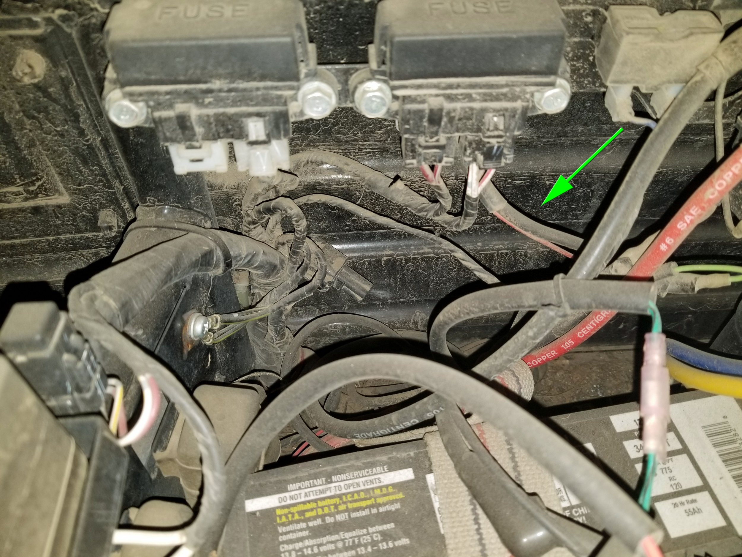

let me tell you what, the electrical system on thing is a mess,,,, from the factory. trying to trace a wire is nearly impossible. heres a pic of switch wires. you can see the encased wires and the red wire
from here i was able to trace the wire to a junction just behiond battery. here its grooped with 3 other red wires and attaches to a larger black wire. the black wire traces all the way to the back of the cart.20221018_183200 copy.jpg
at the rear of the cart, theres a connection point that i could not get a look inside. i was afraid of damaging the waterproof cover. there appears to be 2 wires at this point. it must be a wire thats hot when the key is on. i really dont see why they would run a wire all the way back here, but i traced it 2 times to same spot. let me tell you, theres alot of red wires on this thing. im not sure your will have the same layout.20221018_183045 copy.jpg

Many thanks for taking the time to look, photograph, and post.
Seems broadly similar to mine, but not 100%. As you say, it was a mess to begin with, and not helped by accumulated mud and grime. That's why I'm sorely tempted to simplify life and power directly from the battery rather than ignition, or replace rather than add to the wired switch. That way I know what to tap into.

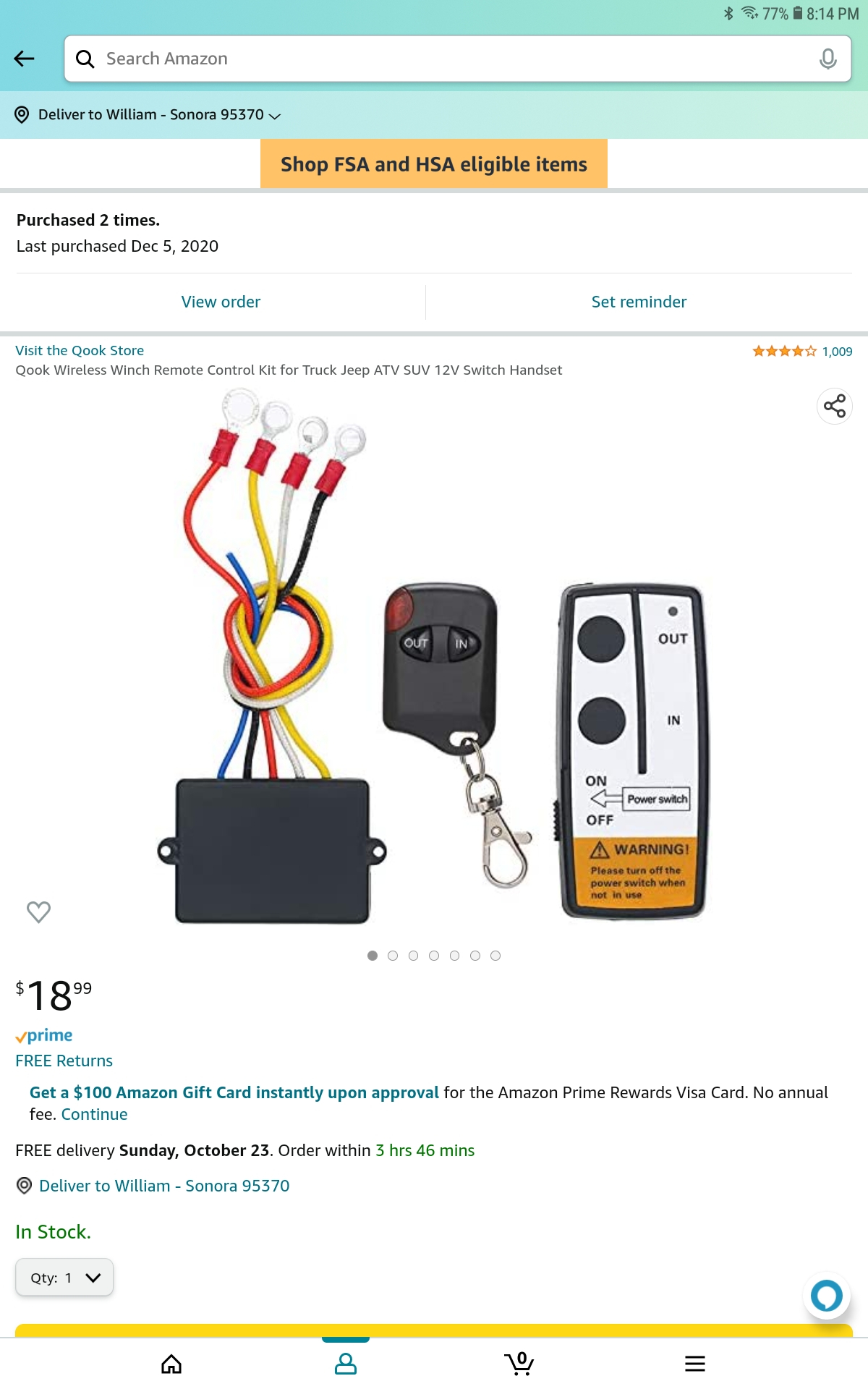

You should definitely go wireless. I installed this on my rtv, and my dump trailer
   / Adding wired remote to winch - is this dumb?
#9
[Amazon product]
Thanks. Pretty inexpensive and good reviews. If I were buying new, I'd jump on it. But I'm first trying what I already had lying around for $0. If I give up in frustration, I'll give this a try.
For my use case, I don't really value wireless that much. When it's under load, I can be in the cab anyway -- logs, not stuck UTV. So this is primarily so I can rewind cable after use under tension without a 2nd person (or tree) helping me. But heck at that price, maybe I'll do it wireless on my other winch/ATV!
