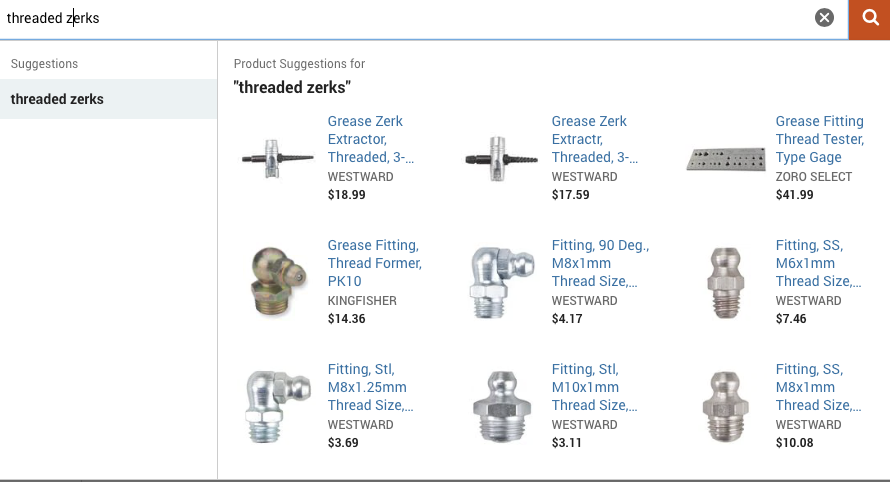

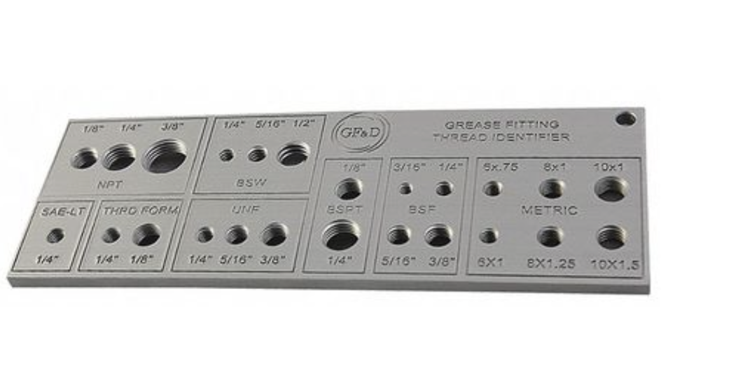

BTW, just to complicate a simple job, ZORO.COM has a great selection of zerks. I went crazy and bought this zerk thread gauge. Do yourself a favor and stick with something simple like NPT....
If it’s in a stressed area, I would probably go as small as I could. Maybe a 1/4-28. lots of fittings out there for that thread And if they do get broken off are generally much easier to remove than tapered pipe fittings.

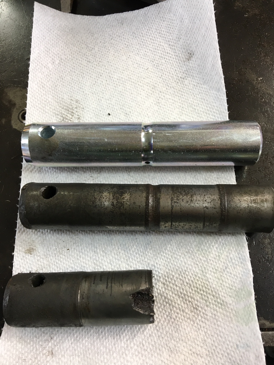

Are the problem pins shown in any of those pictures?Screenshot 2023-03-11 at 10.49.47 AM.pngScreenshot 2023-03-11 at 11.12.46 AM.png
/ Adding zerk/grease fitting? #17
Part 190.
New
Companion
Broke
1080hrs questionable maintenance.
400hrs of heavy lifting since without problems.
/ Adding zerk/grease fitting? #18
Part 190.
New
Companion
Broke
Thanks for the photos. I think that puts it to rest. It looks like either design or maintenance rather than due to poor material.
Frankly, I don't like a pin design that constrains one side of a pin like that. It can lead to lube starvation and a torsional failure - as I believe it has here. Would regular maintenance have changed things? Reduced the wear? .... I just don't know. Regular maintenance with the wrong grease can cause similar problems too.
Bottom line is that particular pin design is a question mark in my mind. It's obvious what the designer was trying to do, and not all bad - but I'm just not completely comfortable with it.
I don't see it as a pending disaster - just a weakness - so I'm not inclined to drop everything & run out and make up different pins and lube channels. But now with 1100 hrs, what I am going to do is pull the pins on our M59 and inspect them.
I'll post to this thread when I do so. I always did want to grow up to be a tribology detective..
