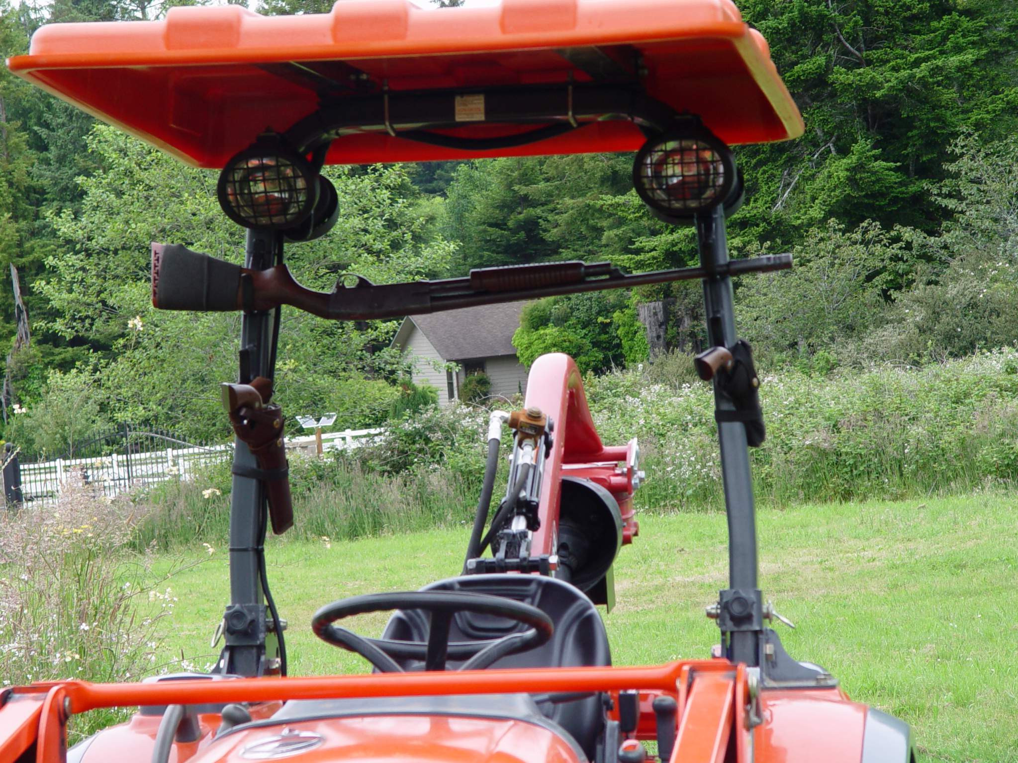

Holy cow quadpa1911. Going to war? You're right near me (Applegate Valley), and I sure wouldn't want to meet you in the woods! I oftentimes carry a 357 on 320 acres, but....
I, too, put regular auxillary driving lights from an auto parts store on underside of my ROPS. Attached w/ large hose clamps. They work well, but are quite a load on the alternator when 2 forward-facing and 2 rear-facing + regular headlights are on. Any recommendations on LED lights? The OP's 90 deg beam LED's look nice.

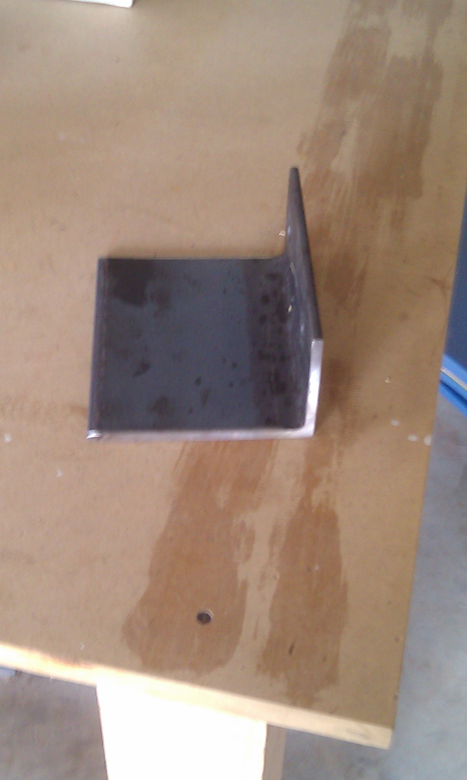

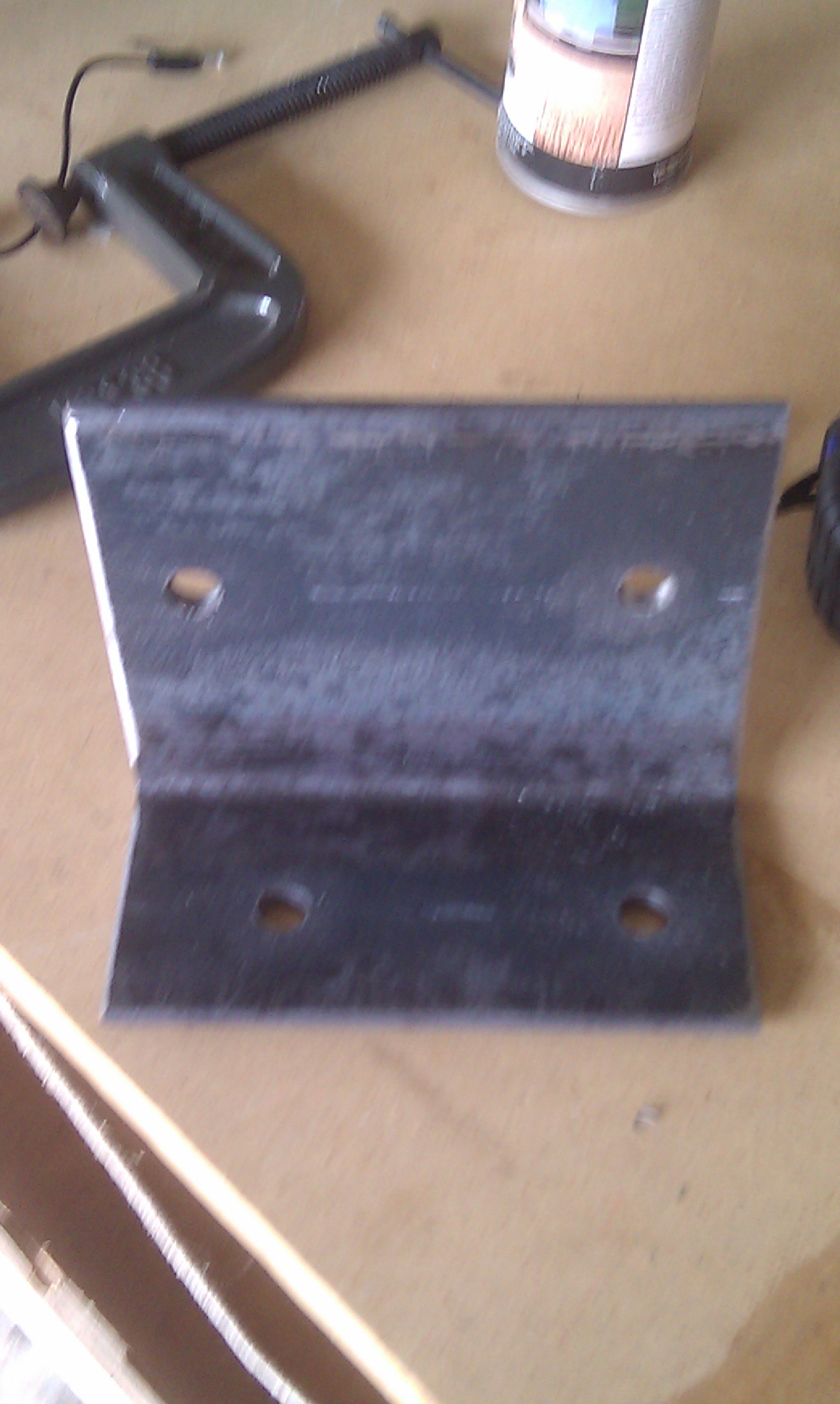

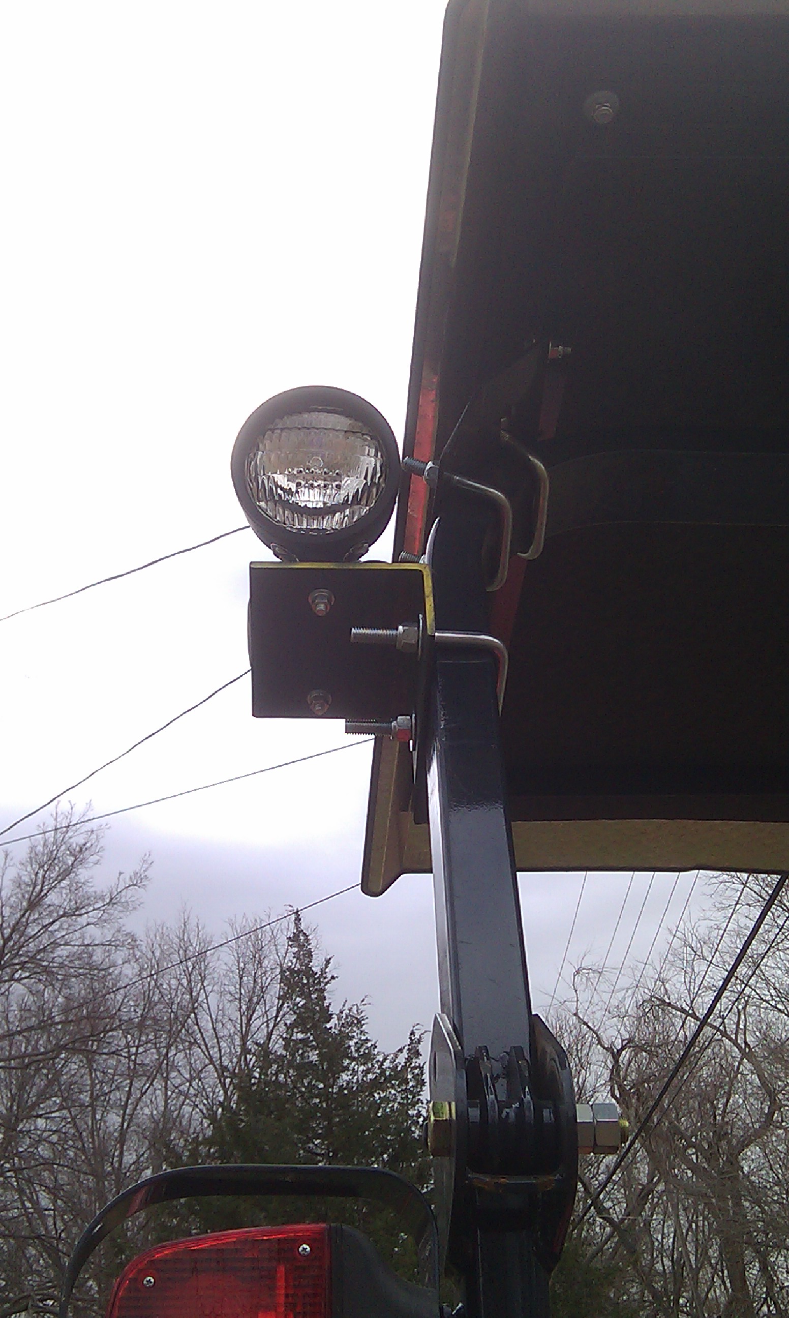

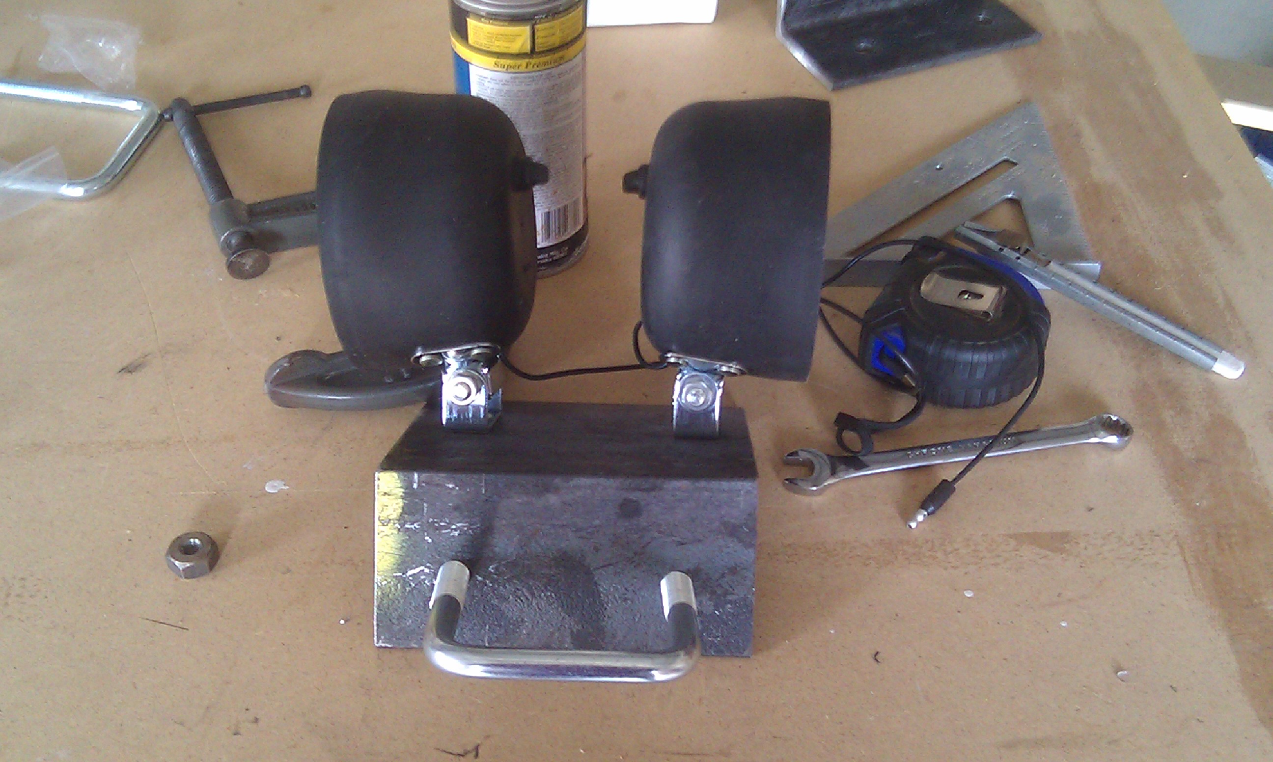

I made these last yr. very inexpensive and easy to mount and aim where you want them to go. mount inside the rops or on the outside. david
/ Additional Tractor Work Light Ideas #29
When I put them togather, they where a trial but they do work well. the lights have independant switches made into them, much like the flash light switch and are also water proof. 55w bulbs. I prefered the independant light switches do to: i dodn't need them all on all the time. And by the way, there is no drilling on the rops in anyway.
Hope this helps
david
