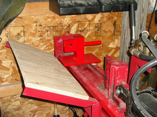

When I made my splitter I made a adapter a few weeks later to use as a shop press.
You can see it sitting on the splitter. Just pull the pin, tilt the cylinder, remove the wedge, install the press adapter.
