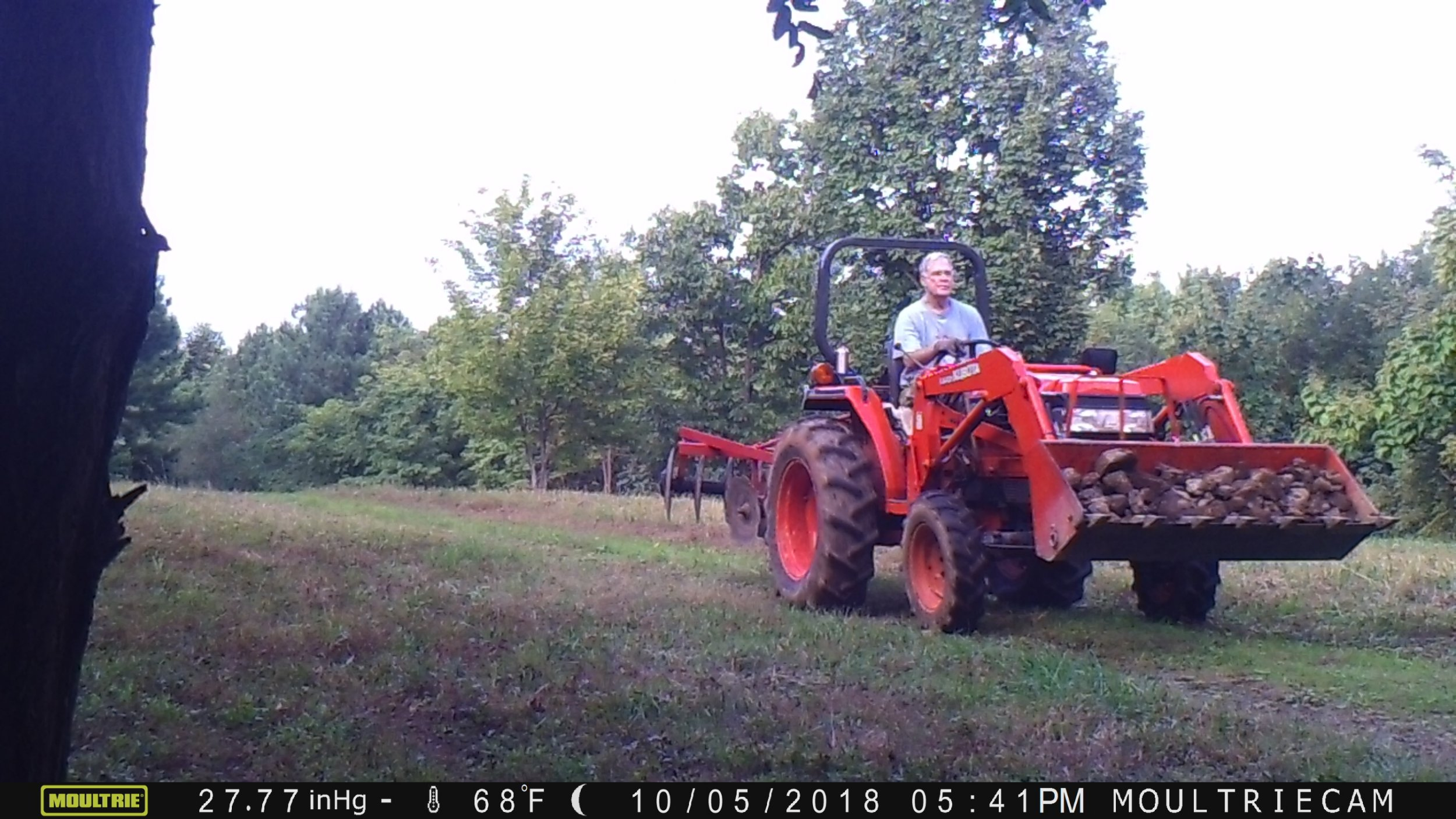

My disk doesn’t always cut the grass on top but the ground underneath the dead grass is always broken. We seed, fertilize and drag. . Never a problem with the plots coming up.

From looking at your ground in your photo of your disc and tractor, you have 2 major obstacles you need to deal with before using your disc. 1st and foremost is the height of your grass/weeds.
1st & Foremost is a deliberate word choice—realize that your 3ph’s only down pressure is the weight of the implement. The weeds cause the disc blades to act more as wheels than blades keeping the disc on the surface. Mown short 3” will continue to be a battle for a disc. I will come back to this in a bit.
2nd issue you have is a 2fold one. You have hard packed soil and rocks. Both of these factors limit your penetration of the ground even after the the grass/weeds are dealt with.
Recommendations:
You can do chemicals to deal with the grass, but the chemicals will do nothing (or less) for your hard-pack and rocks.
You need a plow!
I suggest a single bottom plow (in hard pack, your 3032 is going to struggle from both a HP and weight/traction with a 2 bottom plow) and skip the chemicals. The bottom plow will turn the soil including the roots of the grass/weeds from bottom to top. (Use some caution with the depth if the bottom plow as you want top soil to remain on top—this may or may not be an issue in your area. However, I know it is a major concern in the western/central NC area with the heavy clay in the area my son lives in,)
There are other types of plows, but the bottom plow does the best job of turning the roots up to kill the grass and weeds. They will decay adding nutrients to your soil. Following the plowing , you can disc (I recommend at 90 and 45 degrees from direction of plowing in that order. Remember you are not looking for a lawn finished product, just soil loose enough for seed to take root. A cultipacker is a great tool and one you may want to add, but a light hand ranking has worked great for years for lawns after broadcast seeding. A very light discing can be done as well.
One last point—most areas have a relatively thin layer of top soil so 6-8” of penetration is ad deep ad you ever want to go, in hard pack you may only get to 4-6”. I would guess from what I could see in your photo of your disc, you are only getting 2-3” max.

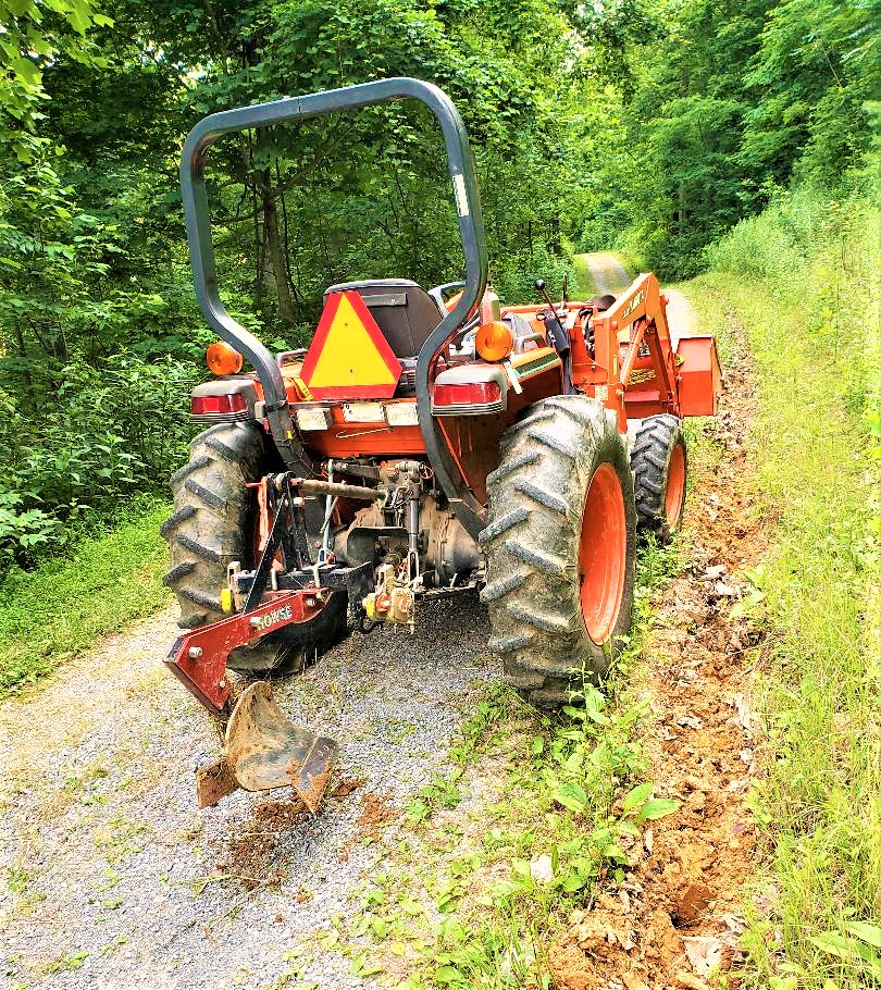

You guys gave me so really good advice and I thank you. I am attaching a photo of my single blade plow. I have NOT used it on my field because I was told that "it will just turn up more weed seeds"
I wanted to buy a rototiller but I have so many rocks that I think it would destroy a tiller. I have started using my box scraper diggers....just shallow cuts and that tears the dirt AND pulls up hundreds of more rocks:mad: But....after clearing the rocks (right:ROFLMAO:) I can plow or box digger some more THEN disk. Thanks

   / Adjust Disk Angles #19
Cut your grass/weeds as closely as you can (at least 3-4” high) then use the fire out of that single bottom plow in the picture. It is difficult to avoid weed seeds, but buried at 6-8” (your plow should turn 6” of soil with little difficulty) the seed should be too deep to ever grow. Once turned with the plow, make multi passes with your disc harrow until you achieve results you want in soil condition. Do your passes at 90 and 45 degrees to the plow direction. This should allow 3 passes in differing directions to the plow direction. As long as you watch the wetness of your soil conditions, this will probably be as much tillage as needed.
You may need to follow this tillage process for a few years till just discing will provide acceptable results. Number of years depends upon soil conditions. The organic material (weeds and grass) will provide nutrients to your soil.
Plowing was typically done in the fall of year to break up and turn under crop residue for organic material to decay prior to spring ground prep (discing, and others depending on planting process to be used). With current no till procedures, plowing is not often done, but is very effective for previously unworked ground.
