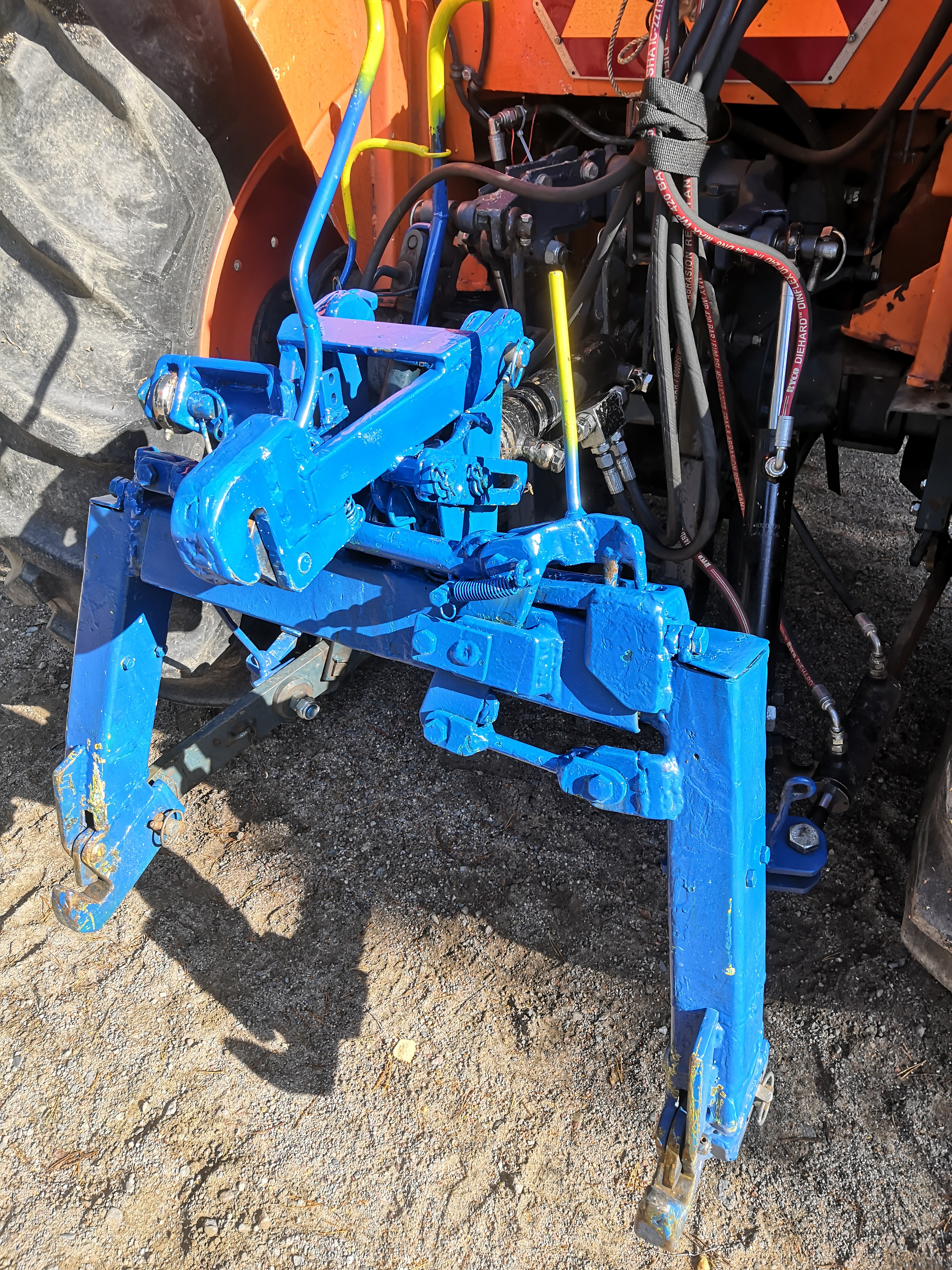

I had the same problem. All my attachments are cat 1 but the width of lower pins can vary from 26 to 32.5 inches . I is cat 1 to cat 2 IMG_20190827_104553.jpg
Also the height of upper pins of my attachments can vary from 15 to 27 inches.
I made my Flexible own quick hitch. It works hydraulic, both the width of lower hooks and the upper hook height.
The upper hook also opens and closes automatic the lower hook latches.
All adjustments are operable from cabin. However hydraulic hoses and drive shaft must join out of cabin.

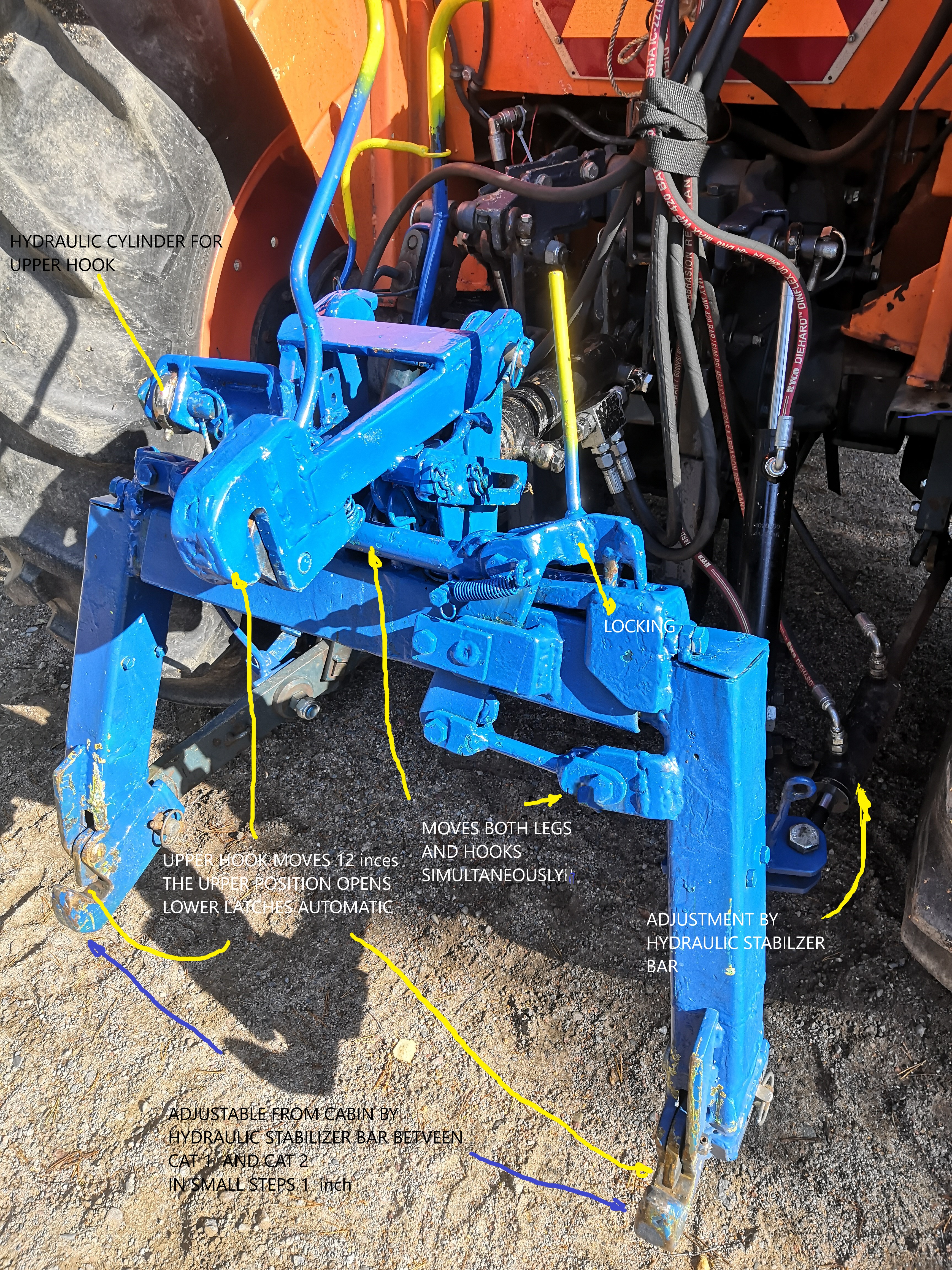

How can your implements all be cat one when cat one is one specific dimension and cat two is a different dimension.... Cat one is clearly 26 inches (+/-) and cat two is 32 inches (+/-)..
/ Adjustable Cat 1 and Cat 2 Quick hitch #14
My quick hitch has the width adjustment mechanism to move lower legs and hooks simultaneously away each other.
Hooks can move between cat 1 and cat 2 in 1 inch steps (26- 32 inches).
This is made from cabin by hydraulic stabilizer bar. There is a lock for locking the legs.
In same way it is possible to make quick hitch suitable for Cat 2 -Cat 3 ( 32 -38 inches)
Also the height of upper pins of my attachments can vary from 15 to 27 inches = all categories.
Upper hook moves by hydraulic cylinder up and down. All adjustments can be made from cabin.
