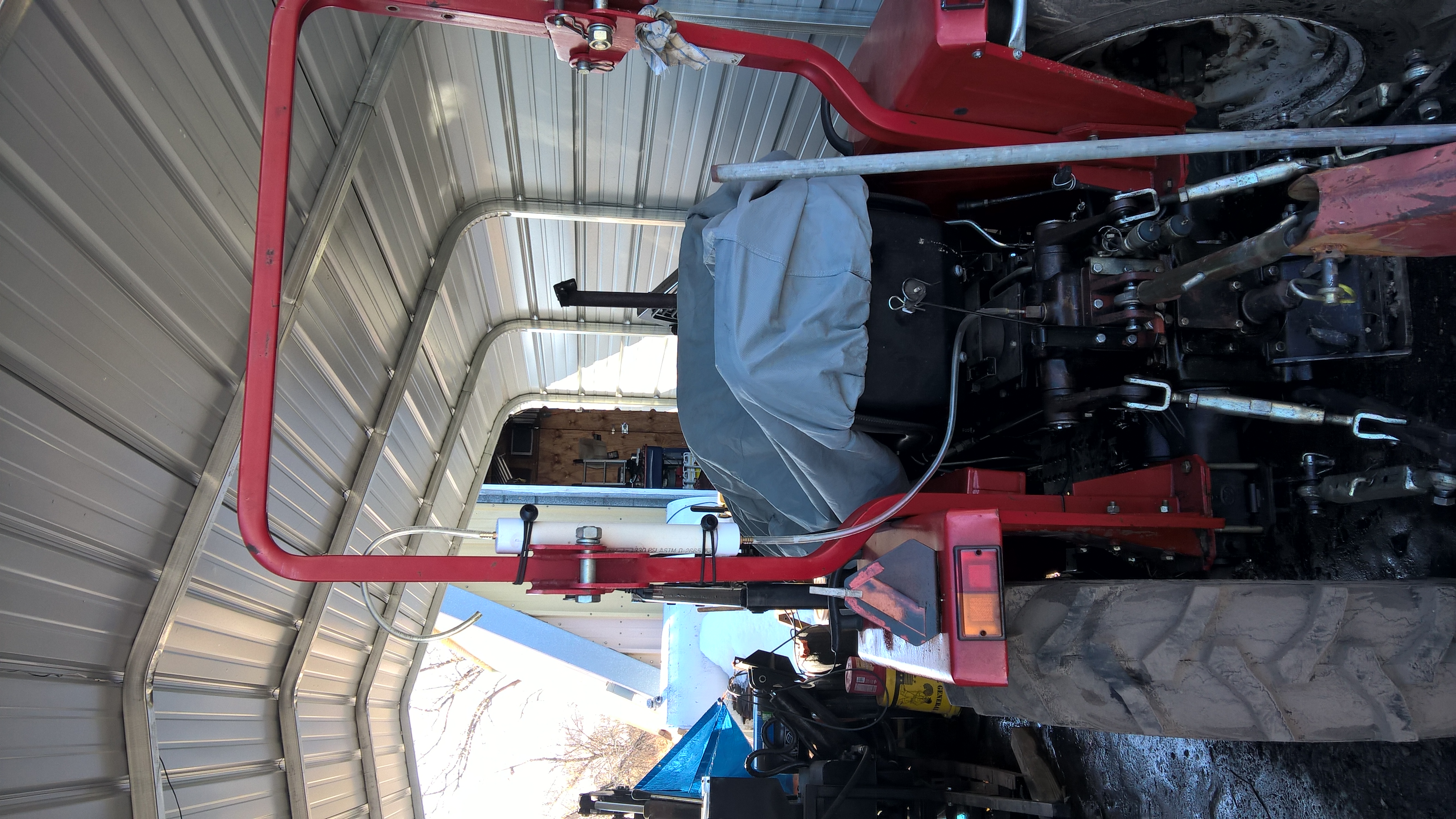

Has anyone found (other than custom) these that work for these tractors, rather than the chains? I致e got a single tab under the rear axle so I can稚 use the Jinmas off the upgrade model. CB579102-624F-4971-9A4A-DE94A0C7C386.png
   / Adjustable rigid stabilizers for 3 Pt Jinma / Farm Pro #2
Replacements for the sway chains? If that's what you are referring to.
Yes I would like to replace the chains with a solid adjustable bar.

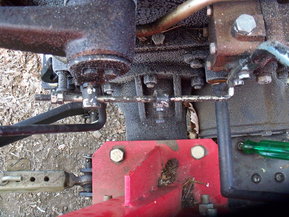

Here is what came on my Jinma 284. They don't take all the play out and the holes don't always line up the best for some implementsneutral rod small.jpg
   / Adjustable rigid stabilizers for 3 Pt Jinma / Farm Pro #7
Yes, and they also help control the side to side sway. Most times I can pin one arm tight but the other one does not line up with a hole so I use the slot instead.
