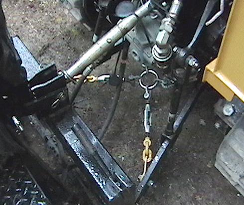

3 point hitches are a great invention. They are also a PITA! I am sure if there were something better, it would have been invented by now. I bought a quick hitch adapter but it has it's own set of problems. IF all of my implements had exactly the same measurements for the 3 points it would work great. Unfortunately the standard is fairly "loose" and dimensions vary enough to make them not all fit. One of these days I will re-work all the implements to make them match. In my spare time of course. :laughing:
That's the problem with older implements and implements that aren't built to ASABE standards. I had that problem with my quick hitch too, and like you thought I'd correct all that in my spare time (Ha!) Spare time seems elusive for me. I fixed it all by getting a pair of Pat's Easy Change latches with the adjustable cross bar for holding, and reworking the geometry of the attachment points and lateral configuration of the sway chains with a center ring. This is an older pic from when I was still using the quick hitch, and before I changed to a hydraulic top link and hydraulic lift.
The hidden end of the sway chains attach at the same point where the lift arms attach, thus bringing the up-down and lateral movement in perfect alignment with the lift arms.
