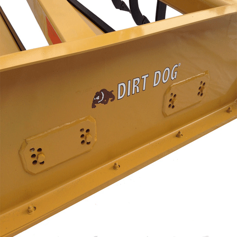

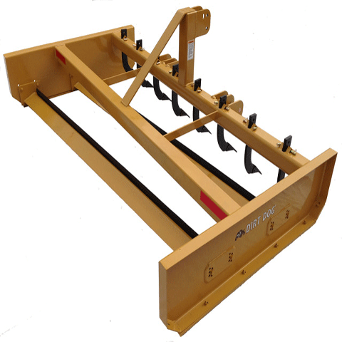

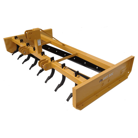

Dirt Dog MFG recently came out with a new leveling blade with adjustable blades. The unit is currently available in a 8Ft unit, but a 7ft unit is being considered in the near future.
This unit can be found on our web site for more details on the link below.
Dirt Dog 8Ft Heavy Duty Road Leveling Blade
