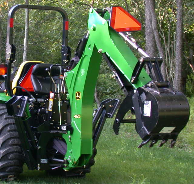

When installing/uninstalling the 485 backhoe to the 4320, I'm having trouble inserting/removing the 2 large pins that hold the backhoe in place. I use a floor jack to lift the backhoe just a little when installing and uninstalling the backhoe. Is there an adjustment for changing the up/down travel of the two top 3 PH arms which are also used for lifting/lowering the backhoe during install/uninstall?? If so, this may eliminate having to use the floor jack.

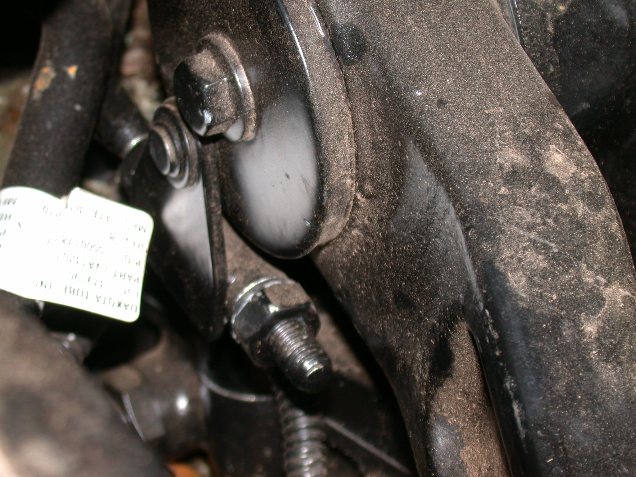

Looking at the back of the tractor: The left rockshaft arm. The pivot of that arm has the pushrod on it. It is kind of a pain to get to with the BH on, but that is how you need to adjust it. I loosen the lock nut, then attach the BH. Raise the rock shaft to full up. Slowly adjust the turnbuckle until the holes line up. While holding the turn buckle with a wrench tighten the lock nut. The pins should slip in easily.

Done. Turned the lock nut 1/4 turn so as to shorten the upstop rod and the rockshaft now lifts the BH high enough to insert the two L-pins. Thanks Tom.

Second, lots of good info here, but could someone post a picture of the left rockshaft arm that has the pushrod and locknut on it that is used to adjust the 3 point hitch? Having trouble with attaching my 485 backhoe to my JD 4120 because the 3pnt hitch is out of adjustment.
