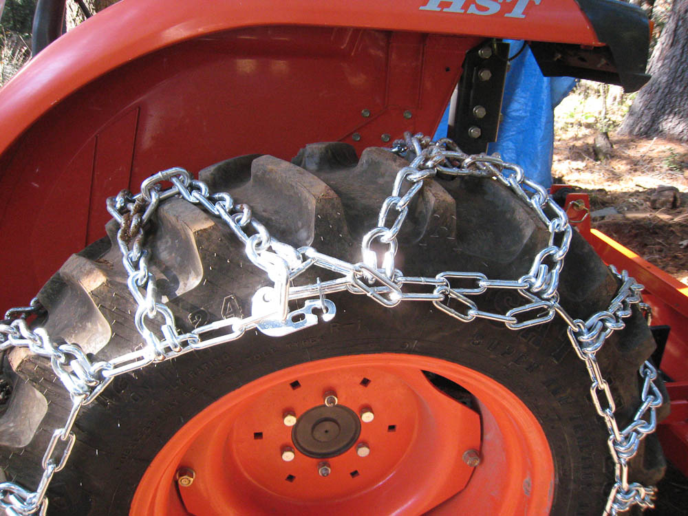

Got my first set of chains for the Kubota... 132 pounds worth. Put them on using the "hook 'em on and drive forward" method. That worked pretty well. They went on easy and straight the first time.
Two things I would like to hear your comments on:
They are a bit long for my tires and I have read how you can remove a cross link if needed. However, these are the "duo-grip" chains where each pair of cross chains is linked together. And I would only need to remove one cross chain of the pair. That doesn't seem like a good idea. I would have to cut off the links to the next cross chain and would also end up with a gap. Right now the free ends of the side chain are attached at the link after the first cross chain. I'm thinking of just securing all the loose stuff and leaving them as-is without cutting or removing anything. Your thoughts?
Second question: all the loose bits are currently secured with bailing wire (I know, but it was handy:ashamed:). Is this a reasonable solution to keep thru winter? Or should I look for some small quick links or clevis to secure the ends that would otherwise dangle?
No snow in the forecast yet, so I have some time to get it straightened out.

On your first question
Did you deflate the tires slightly and air them back up after you secured the chains at their tightest connection point?
How long an overlap do you have? is chain is riding on chain?, if so thats a no no. You need to order a tractor chain repair tool from chainsrus.com in Denver, Co. (tirechains.com does not have any tooling in stock (been there done that) The repair tool is worth the cost as there are no banged knuckles or torn skin.
I had my chain order in three days as of this past Wed and they were great folks to work with.
No on the purchase of shackles!!, as they will loosen up without blue loctite.
Purchase several (6) plus of the quick chain repair links that are the type with the hex nut that opens the link; then you can tighten it back up with a wrench and no worries about any loose chain flailing around.
You should invest in set of chain tensioners for the rears to keep them tight as they can slip(been there done that, re done that, you can use bungee cord if you want to but the spring spoke tensioners are a bargain considering the aggravation of slipping chains.
1. ANY loose chain is a problem waiting to happen.
2. Repeat, any loose chain is a problem waiting to happen.
3 Read number one and two again
happy holidays

Assuming you tightened the chains as much as possible with the latch and hook. If there is a lot of chain left over, you can use baling wire to hold that on to the outer links.
Do you have chain tighteners? One form of these consists of a thick rubber band with 5 or more hooks on it that attach to the periphery of the chains and tighten them. They take the slack out of the chains.
You can also use tarp rubbers or bungee cords to do the same thing. I have a heavy duty set that is made out of springs and chain for my chains.

I thought a picture might help. Hopefully the glare from the sun does not get in the way too much.
There are 6 side links on the loose end before you get to the first cross chain and then 3 links to the second cross chain in the pair. The buckle is hooked to the middle link between a pair of cross chains. Or another way of saying it is the buckle is on the 9th link from the end.
I like the idea of the quick links. Those should be stronger and less pokey.
I'm still open for comments, but I think I'm zeroing in on what I need to do.

I'd just use a couple of small clevis's or quicklinks to fasten the second ("beyond") sections of the crosslinks and keep an eye on things. The inner sidelinks of my chains go on with 1/2" bolts, washers and self-locking nuts. Didn't have enough of the proper latches when I made up the chains, now I have them sitting on the shelf don't have time to install them.. Been fine for 6-8 yrs without them...
Have you driven on those chains since you installed them? I tighten mine as much as possible when installed, the 1/2hr later can get another link in the outer side chain. Probably do this once or twice more before I'm done.....(the inner side-link stays a fixed length) Then I install bungees....
   / Adjusting Chains #9
Ive been looking at your chain situation and my question to you is your inside
connection looser thus forcing you to over tighten the outside side link?
Try balancing the inside/outside length by hooking up both of your side links (inside then outside)to the link after the last cross link this would be the tightest your chains could be if you did no mods.
If those chains are for your tire size they should fit nice without removing a cross link especially with brand new rubber like that.most of that loose side link chain after you determine the proper length could be cut off to leave you like 1 or 2 extra links that would look a lot cleaner.
try that and like others have said get yourself some chain tensioners. I own some and they do work good.If your chains are a little loose it wont really be a big deal on a tractor at slow speeds.Higher highway speeds on cars and trucks require very tight chains so when they expand they don't hit the fenders your chains will never see that type of situation.

In looking at your picture , I would try what Reggiejr posted . Unhook the out side then rehook the inside as tight as you can get it , then rehook the outside . I dont know , least I can't put my finger on it , but something just seems " Off " ?? Meaning , are they the right size chains for those tires or ???? Seems like they are to long .
When ever I have had to cut down a chain or when hooking them up an a cross link comes into play , the chain was made for a different size tire . , usually a standard 22.5 chain going onto a 22.5 low profile tire . Course I am talking Semi truck , but my first impression in seeing your picture is that the chain was to big for that tire .
