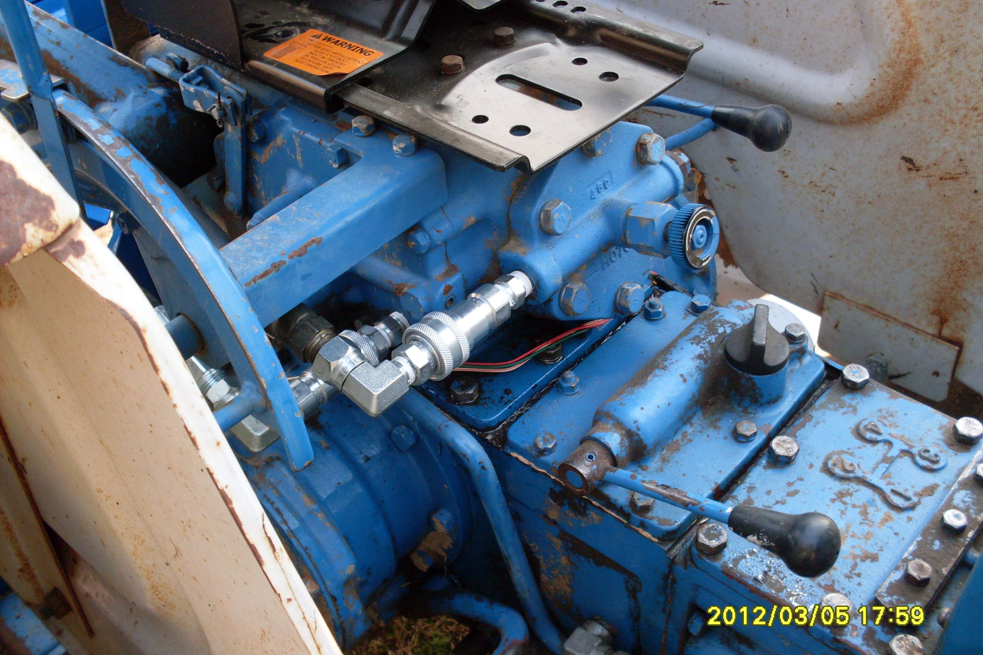

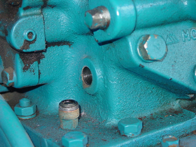

Sure! All I did was tap into the 3ph hydraulic circuit at the test port, located just to the right of the adjustment knob under the seat. That will be the pressure port. You simply remove the 1/2" pipe plug and install a female hyd quick coupler. Next you remove the 1/2" pipe plug from the side of the housing (just a few inches aft of the pressure plug) and install a male hyd quick connect. I have attached a couple of pics.
The top one will obviously be the pressure line, and the bottom is the return. You will want to use opposite fittings so there is no possibility of hooking your hoses up wrong and I chose to put the female on the pressure port so I could buy a hydraulic test gauge and simply install a male quick coupler into it to use as a test tool (cheaper than having to purchase another female coupler for the test gauge).
Now, the way to energize this port to operate the hoe is by moving your 3ph control lever to the top just like you would to raise the arms, then you will have to move it sideways to raise it just a little more to that upper most notch on the control assy. This will raise your arms to the upper most position and keep the port pressurized constantly. Don't forget to lower the control arm to de-energize the circuit before you disconnect the hydraulic lines to the hoe when you remove it or you will dead head the pump.

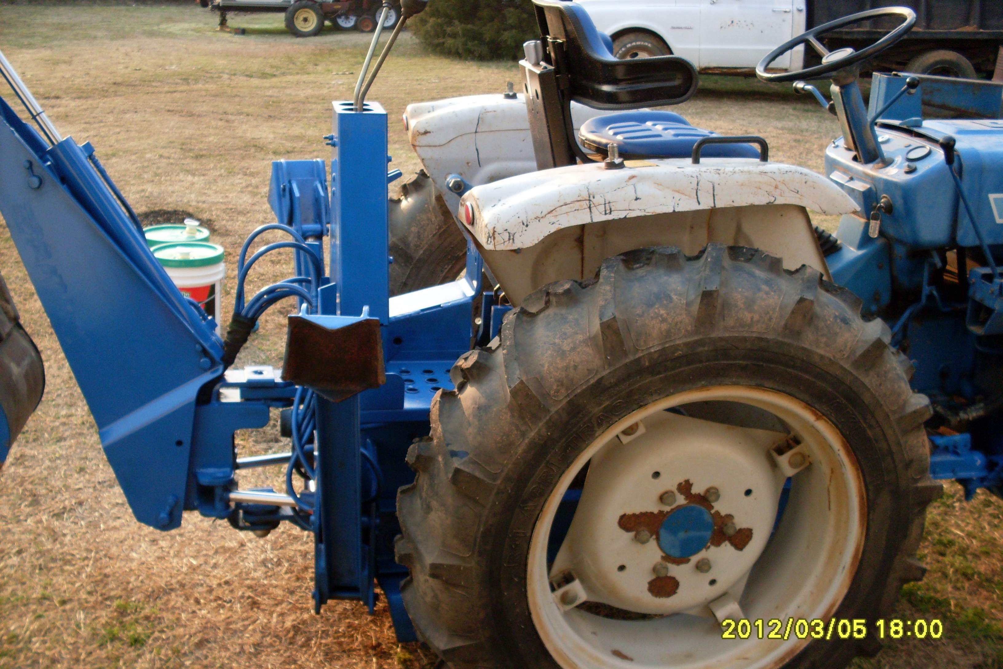

Here are some pics of my setup.

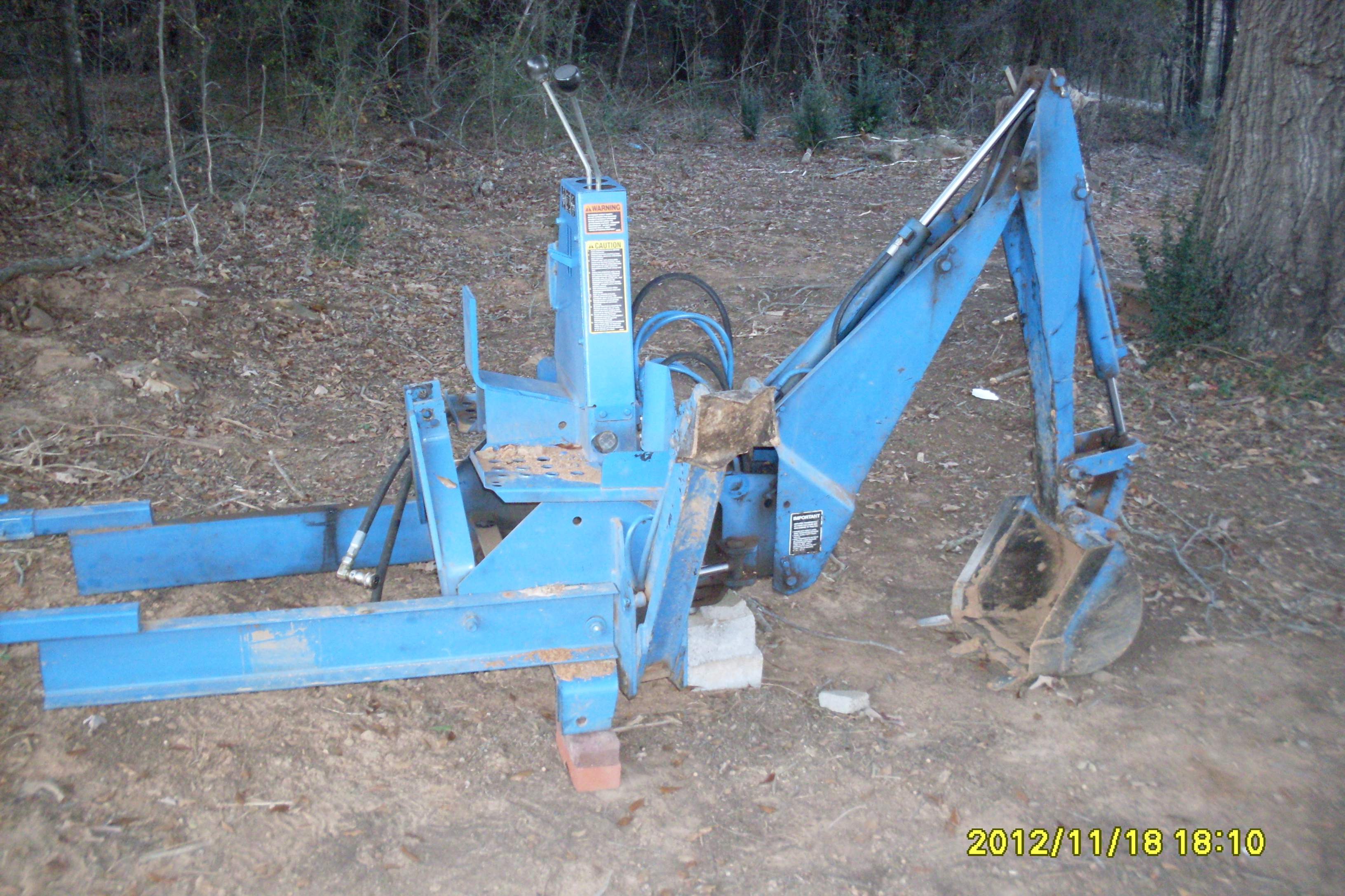

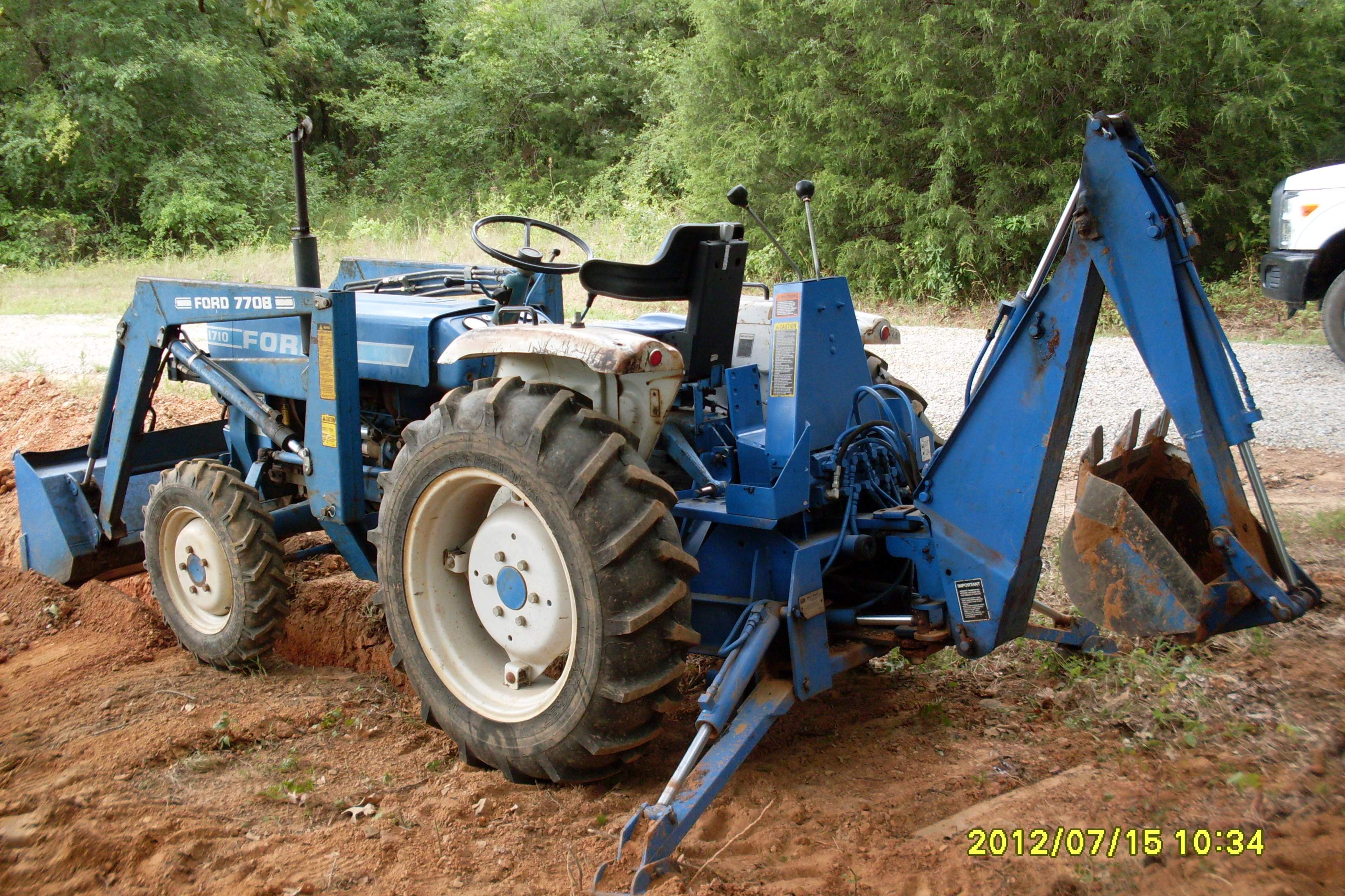

Here are some more pics of my hoe and setup.SDC10280.jpgSDC10394.jpgSDC10338.jpg
