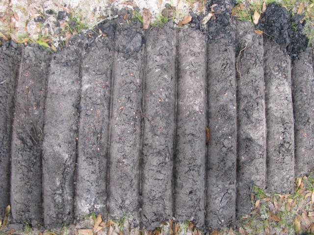

I hope that isn’t a finished harrowing job, because around here we would consider that a poor job. A good job shouldn’t any ridges or any valleys.
   / ADJUSTING Three Point Hitch Mounted TANDEM DISC HARROWS
#12
No, it is not. Just an illustration of how wide front gangs toss soil when Disc Harrow is pulled at a brisk pace.
#13

Going to be broadcasting 1.5 tons of mixed seeds: cowpeas, pigeon peas, canavalia, moringa and castor bean.
The large plot, which is currently cow pasture will be prepared with subsoiler, 5 bottom plow, and disc harrow.
Would a second pass with the disc harrow be good enough to plant (partially bury) these mostly bean-sized seeds? Or would they maybe go too deep?
If you adjust the gang angles on your Disc Harrow to relatively minor angles, the DH will bury seeds less deep.
If you adjust your Top Link so 40% of the weight is on the front gangs, which throw dirt out and will leave seed on the surface, and 60% of weight on the rear gangs, which gather dirt in, covering the seeds, you should be good with bean size seeds, assuming you subsequently have 3/4" or more rain per week.
(Rear gang is wider than front gang.) (Longer Top Link transfers more DH weight to the rear gang.)
In addition, use the Three Point Hitch hydraulic position control to just set the DH pans just into the soil surface.

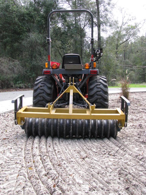

Smaller seeds often require sunlight to germinate. Covered, small seed germination declines. Small seeds are best pressed into the surface of the soil, uncovered, with a Cultipacker. PHOTOS
