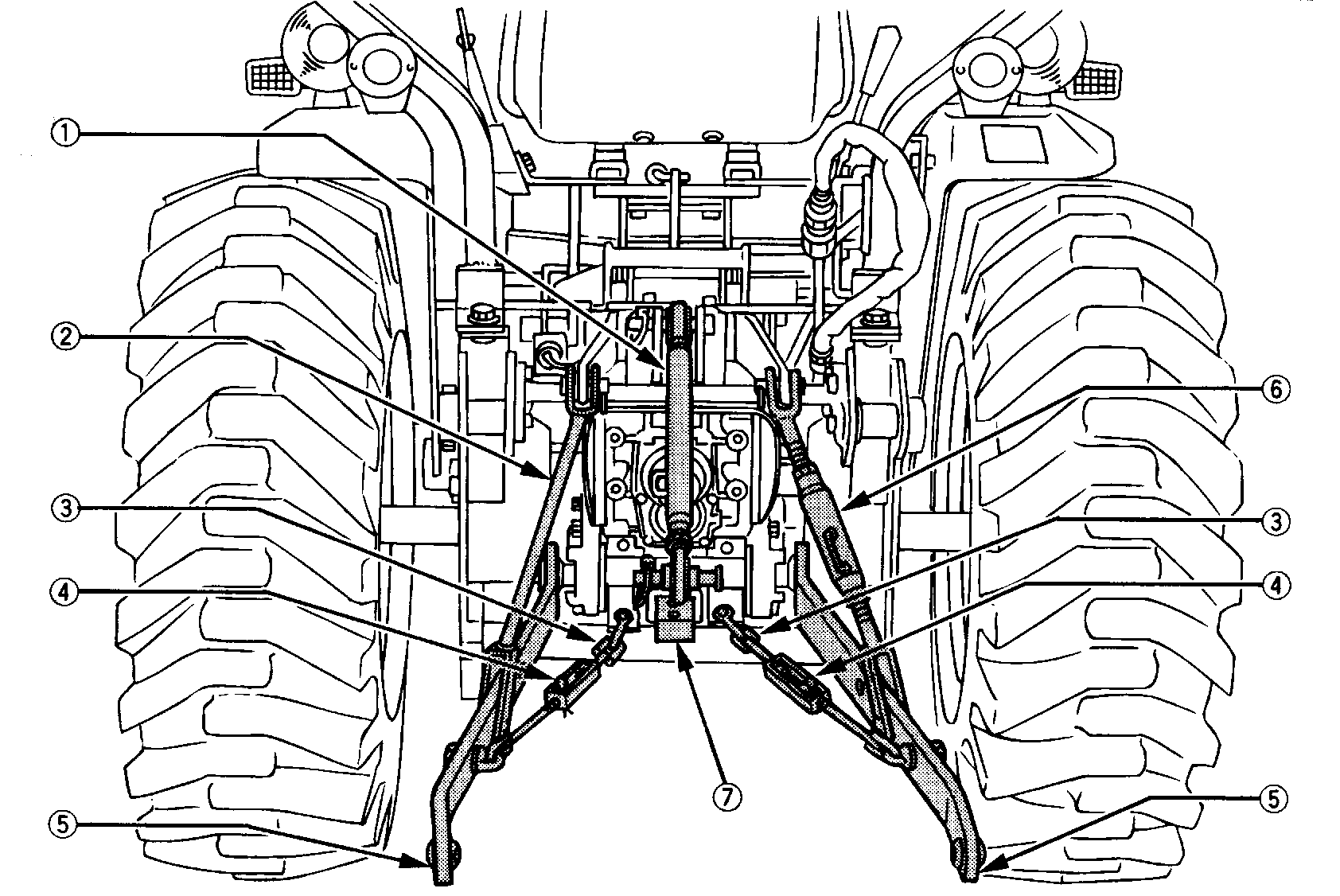

Are you on level ground? How is you side link adjusted?

Some clarification is needed:
Is the implement too far to the left (when you are sitting in the seat; facing forward)?
If so, you may need to adjust your chains, stay strap or adjustable stabilizer bar, depending on how your hitch is configured:
Click on this one:
As you can see, there's more than one way to skin a cat, so a picture of your hitch would be helpful.

It almost sounds as if he is using an offset attachment, where he hooked up to the bottom pins but the top is off.? I think I could be wrong.
