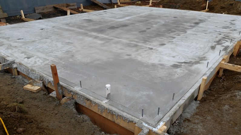

I pick one up a few months ago with only 242 hours on it. It was a "home owners" tractor and was well cared for.
It's my first tractor and I'm spoiled! I've already put it to good use getting my monolithic slab in. GREAT tractor!!!

That is one impressive slab, btw--did you do the excavation with your B3030's BH, and did you make the forms yourself?

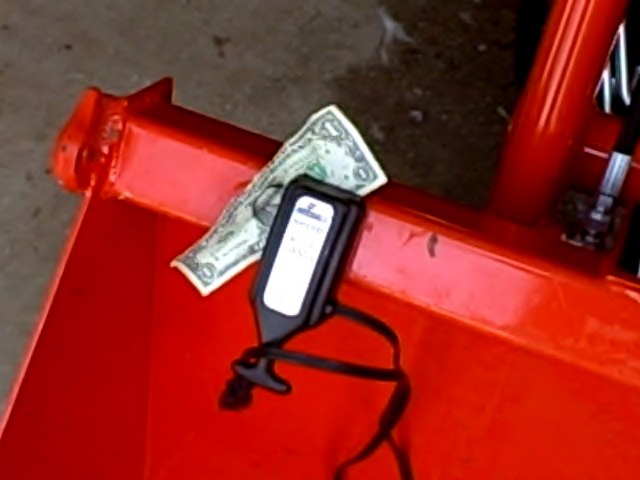

In my opinion, I like the magnetic block heaters. You don't have to worry about anti-freeze leaks and you can swap them between vehicles/tractors. I too love my B3030--I would just hate a Tier 4 engine.

I dug the slab with the 3030. The foundation is 18'x24'. I dug down around 3 feet around the footing area 16" wide and about 2.5 feet over the entire center area. I had it dug out in a weekend. I made a ramp in a 6' wide area in the center of the 24' length so I could get in and out to dump the stone. I then dug out the ramp section and dropped the rest of the stone in and moved it by hand. Worked out pretty well. I made the forms and did the rebar myself. I had a friend who does concrete work for a living do the pour. It took 17 yards of concrete. I'm very happy with how it came out. Will put the building up in the spring.

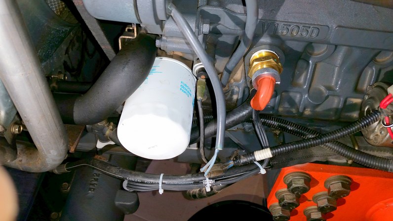

The block heater is a Kubota item I purchased from "Coleman Equipment" website. Here's the link...BLOCKHEATER 70000-73274. It's basically an electric water heater.

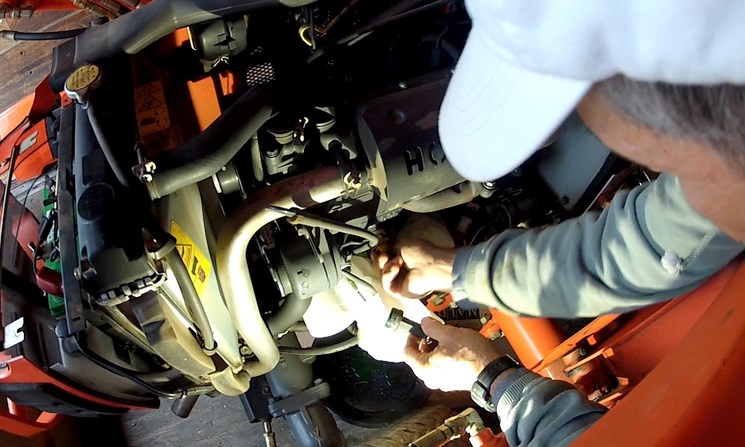

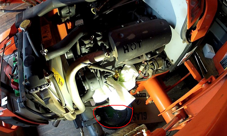

As far as the install it took less than an hour. All you need is a 1/2" drive 17mm allen socket (bought a set from Sears) to remove the threaded engine plug and a 35mm socket to tighten the heater element. I didn't drain the block. I simply placed a catch pan under the engine and placed a bunch of paper towels under the plug area. I loosened the plug with an impact gun, had the heater element ready in my right hand and removed the plug with my left and quickly inserted and hand tightened the heater element. I only lost about a 1/4 cup of fluid if that. I just snugged it up tight with the 35mm socket. After installing it I plugged it in and it got warm pretty fast so I know it works. I checked the radiator fluid next, didn't need to add anything, then ran the tractor for about 15 minutes to check for a leak. Everything was nice and dry so it should be good to go. I know a lot of people say you don't really need it but when the temps get in the teens and below I figured it has to help save a little on the wear and tear of cold starts.
Here's a few pictures...
Engine plug is circled in red.
Here I'm quickly swapping out the plug with the water heater.
It's a little hard to see but there's very little fluid in the oil pan circled in red.
Here's a close up of the heater.
If you have any questions feel free to PM me.
