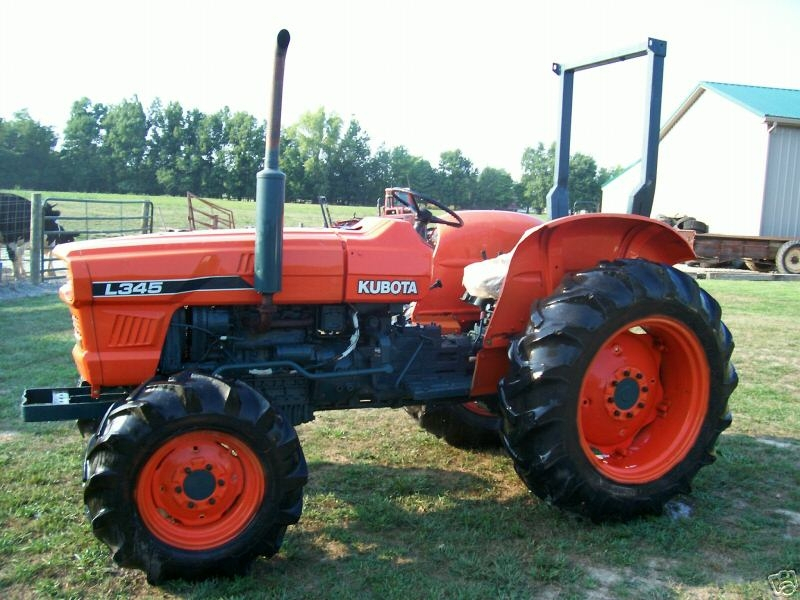

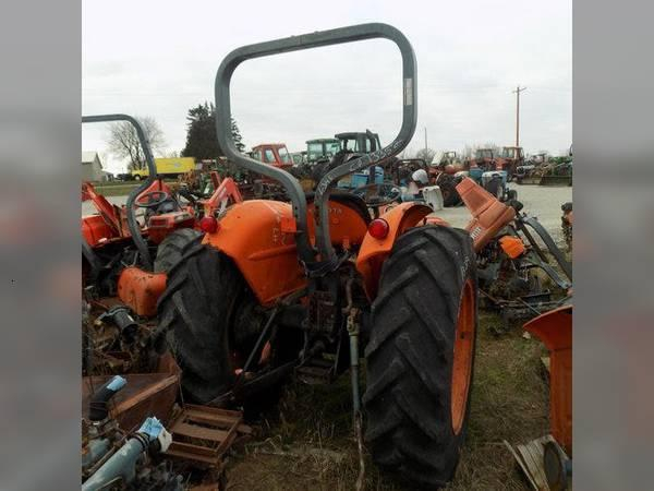

Kubotas like this were sold with an optional axle-clamped ROPS (first pic). Later, when they realized very few were being sold, they decided to offer a nifty ROPS for L345 and L355 tractors that attaches with long thru-bolts at the top 3-pt connection at the back end of the trans/differential case (second pic). To encourage owners to get one, there was a low-price program for it. Not sure if its offered any more. I would guess there are some on dismantled machines in yards? This one is an old picture from "fastline"??
Thanks for the photos and history. It's much appreciated.
