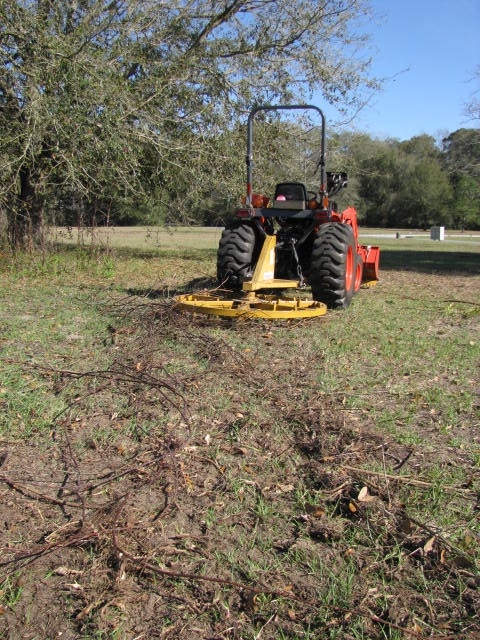

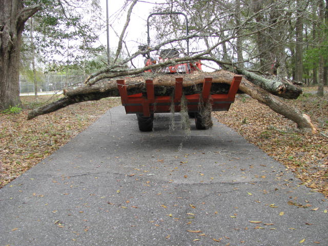

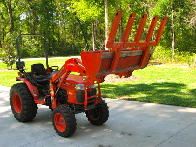

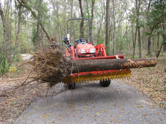

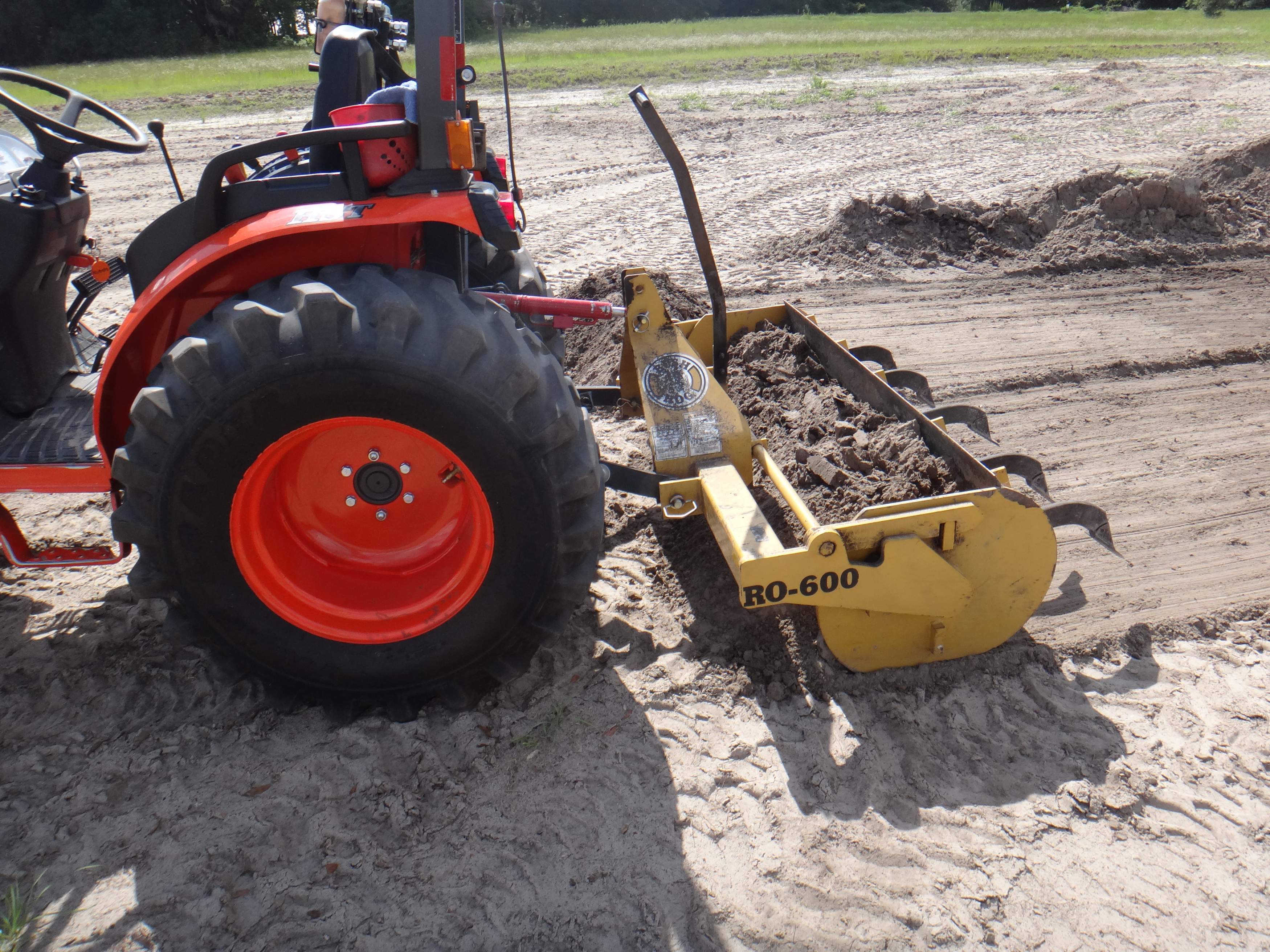

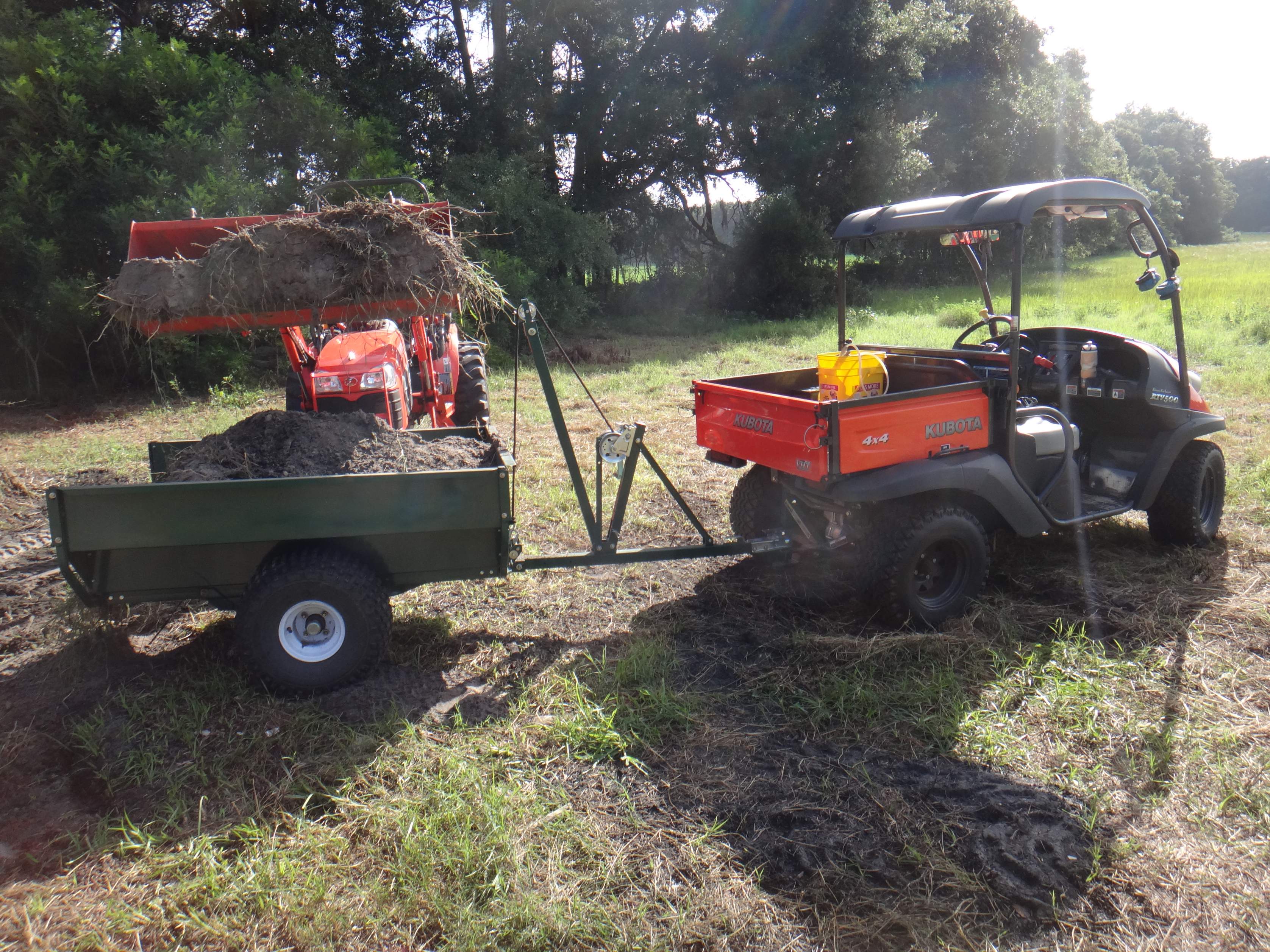

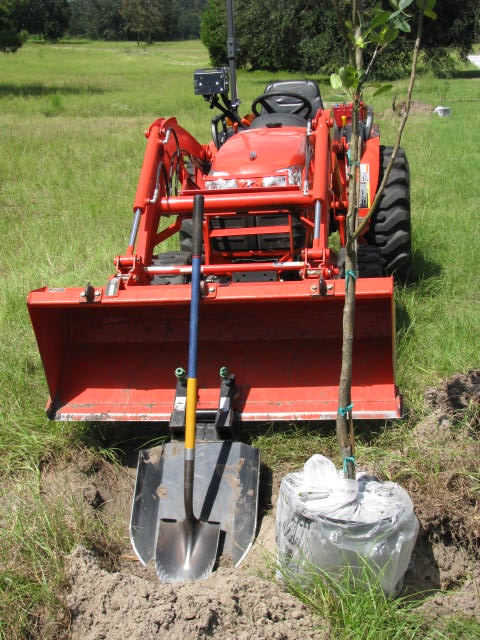

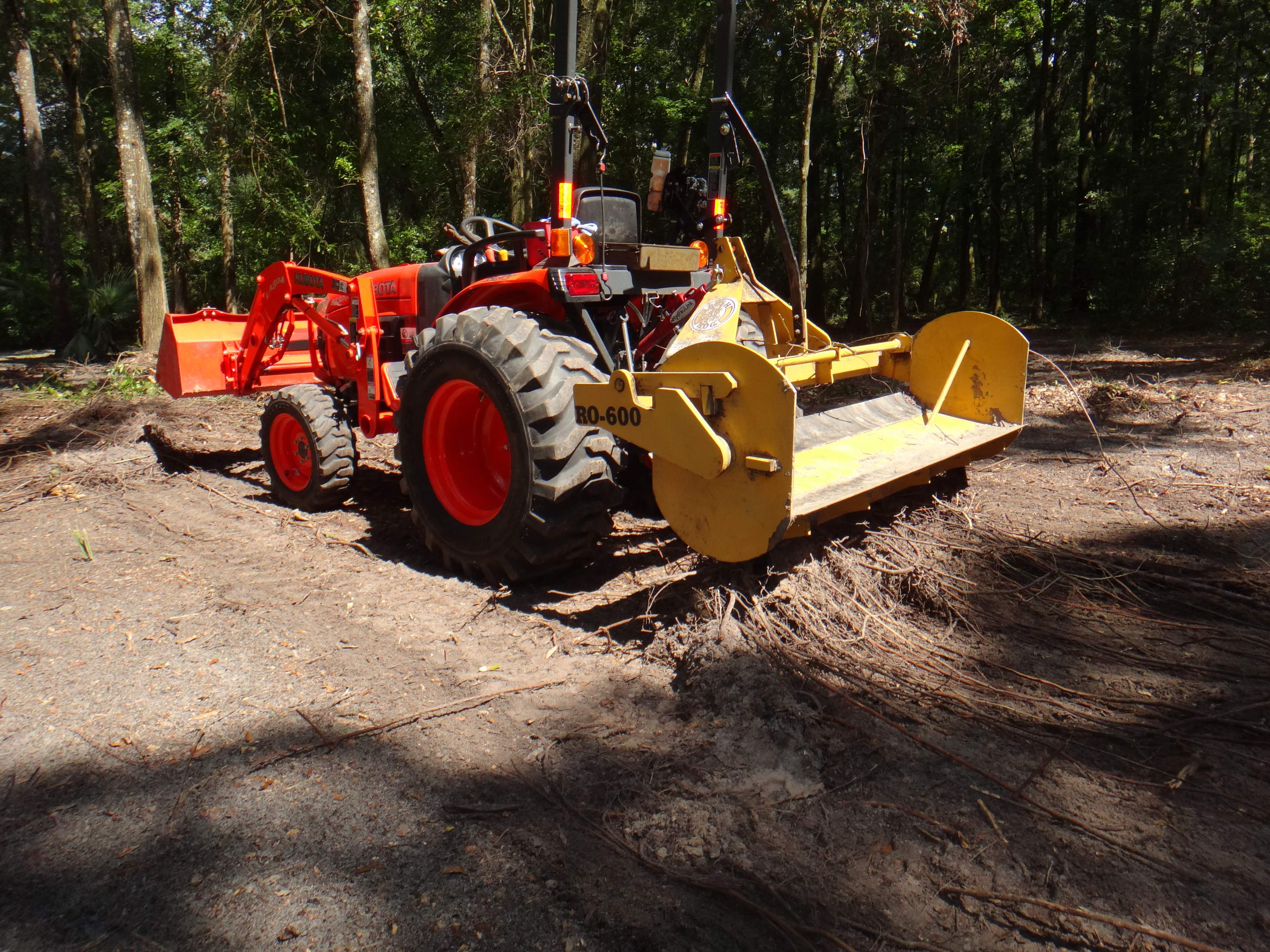

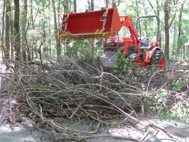

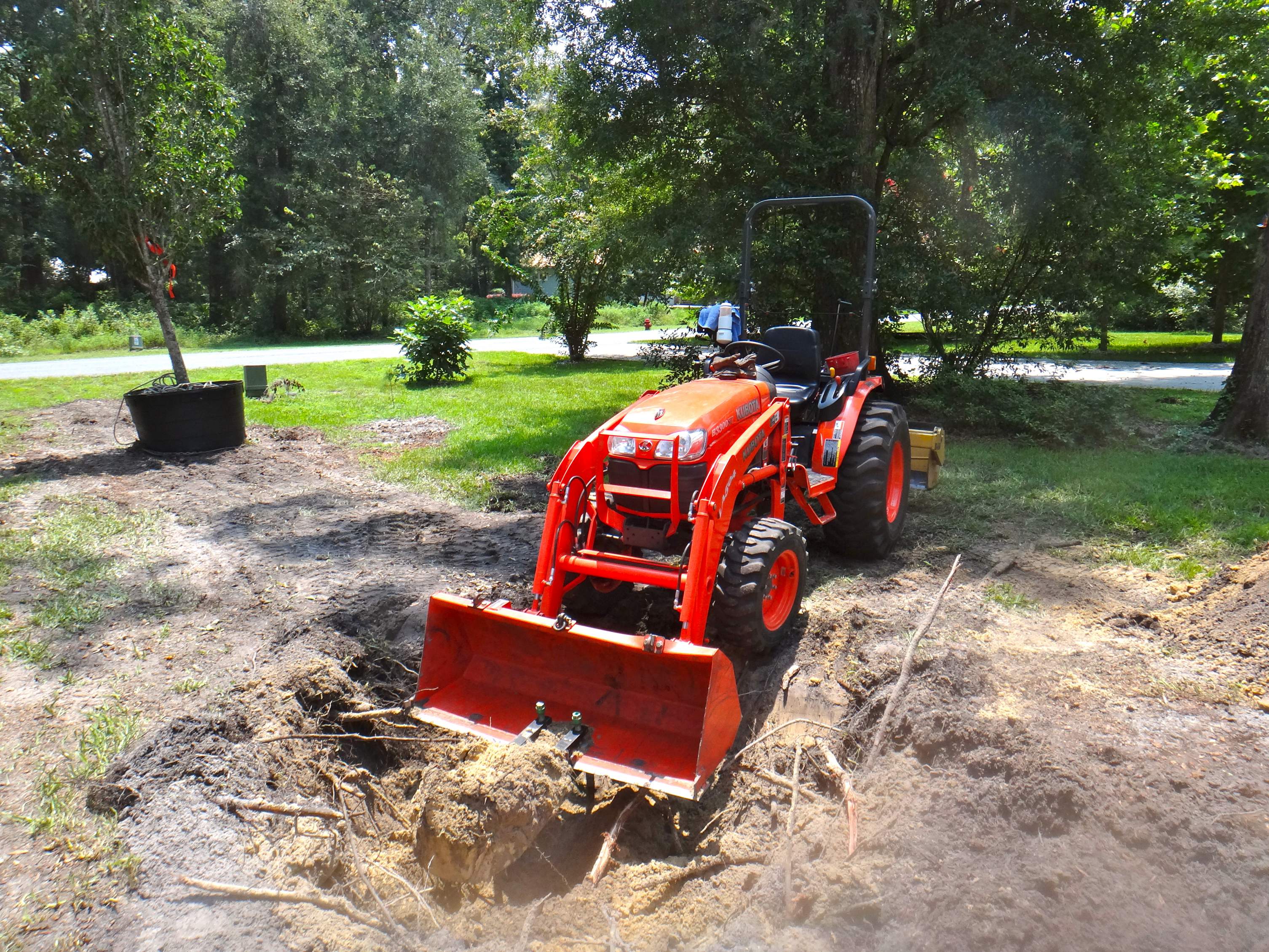

Also consider the Kubota B3300SU tractor/loader package. If the components are agreeable to you, the B3300SU will save you approximately $1,500 dollars over the price of assembling same components on a B3200.
I do not own a log splitter. I pulled a King Kutter 48" rotary cutter in HST/MED easily. I acquired the KK used. The B3300SU is now pulling a 72" Bush Hog Squeeler, without issue, says the new owner. Also pulled a Howse 16/18" disc harrow in HST/MED and a 60" rollover box blade in HST/LOW/MED. All this with industrial tires - R4s.
Where I live in Florida we never have mud. Soil is sandy-loam and we are over the aquifer. One hour after a heavy rain the soil is moist but not muddy. Traction was very rarely an issue. The front/rear balance is perfect on the B3300SU.
On my new L3560, with LA804 FEL and L2296 heavy duty, round back bucket, the weight distribution is more forward, so I need an implement on the three point hitch most of the time.
B3300SU was very capable. After two years and 400 hours I decided I was working B3300SU at max at little too much as I became experienced and should have a heavier tractor. The L3560 is more capable but much bigger/less maneuverable.
B3200/B3300SU is a really good size tractor to learn on. During the first year I was glad my Kubota dealer is only six miles from the house, so I could drop in to ask questions about tractor technique and implement recommendations.
(Take a look at 120 volt electric powered log splitters rather than tractor mounted. Cheaper ($300 total cost) and less complicated.)

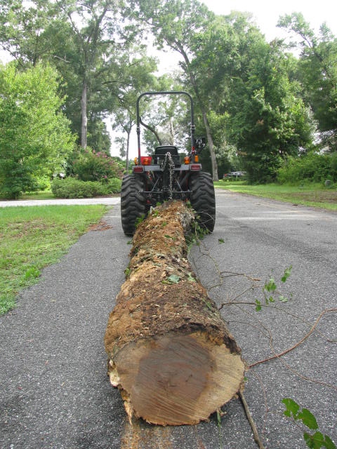

I take it from your photo of dragging that log that you found the tractor to be adequate for drawing capacity. I live in an area that gets a good bit of snow, so I would like to be able to drag a car out of snowbank, etc. This is why weight is a concern for me (though with the loader and with an implement, this helps obviously).

I doubt a B3200/B3300SU would have enough weight/traction to pull anything more than a sub-compact car out of a snowbank.
