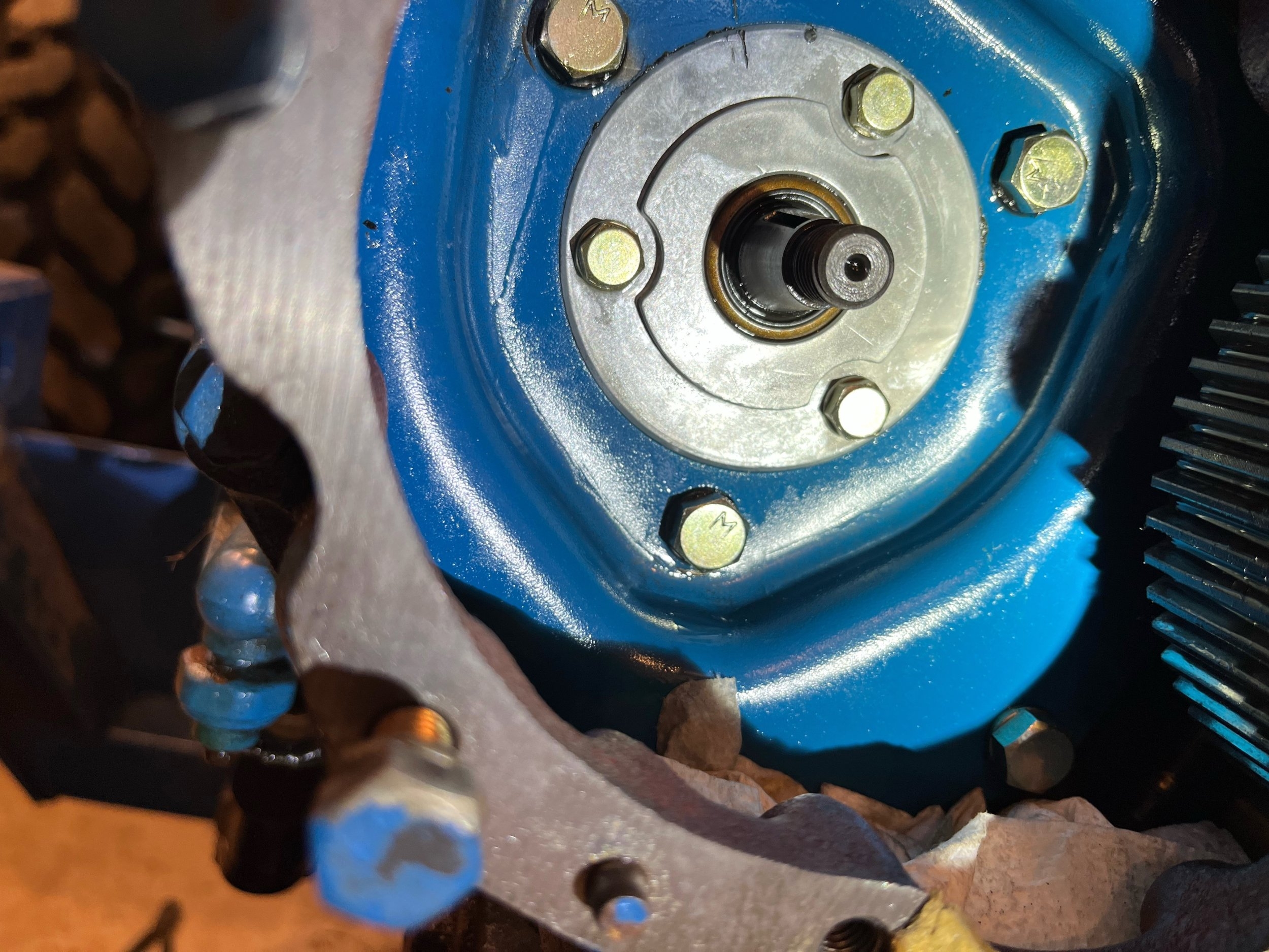

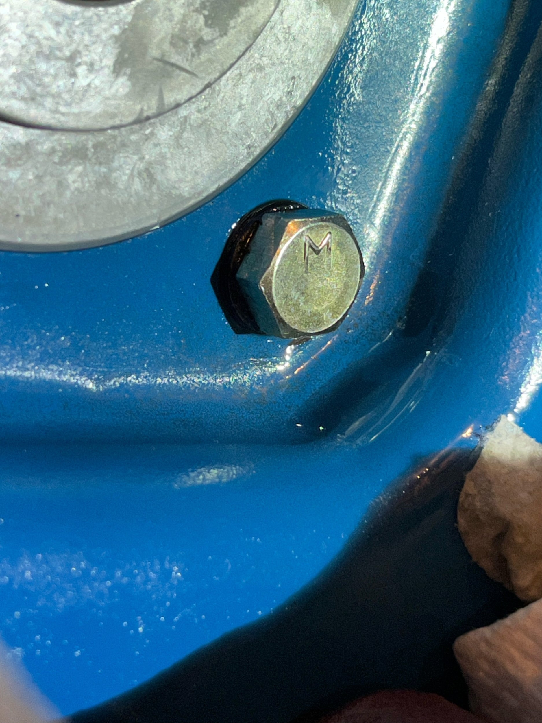

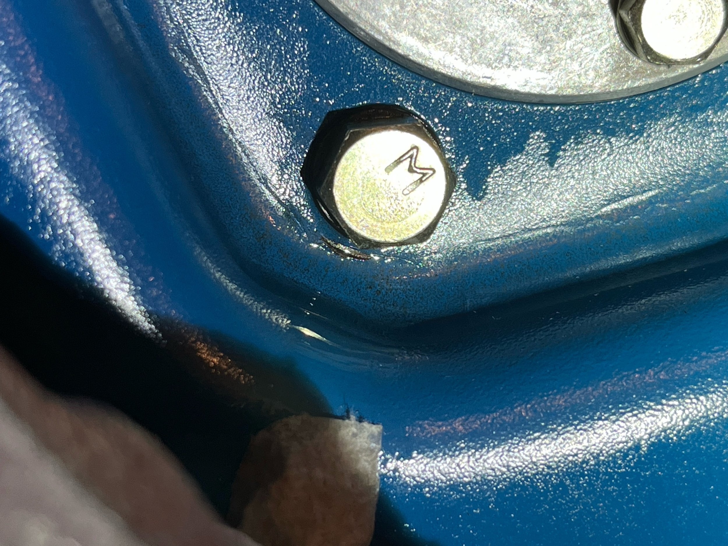

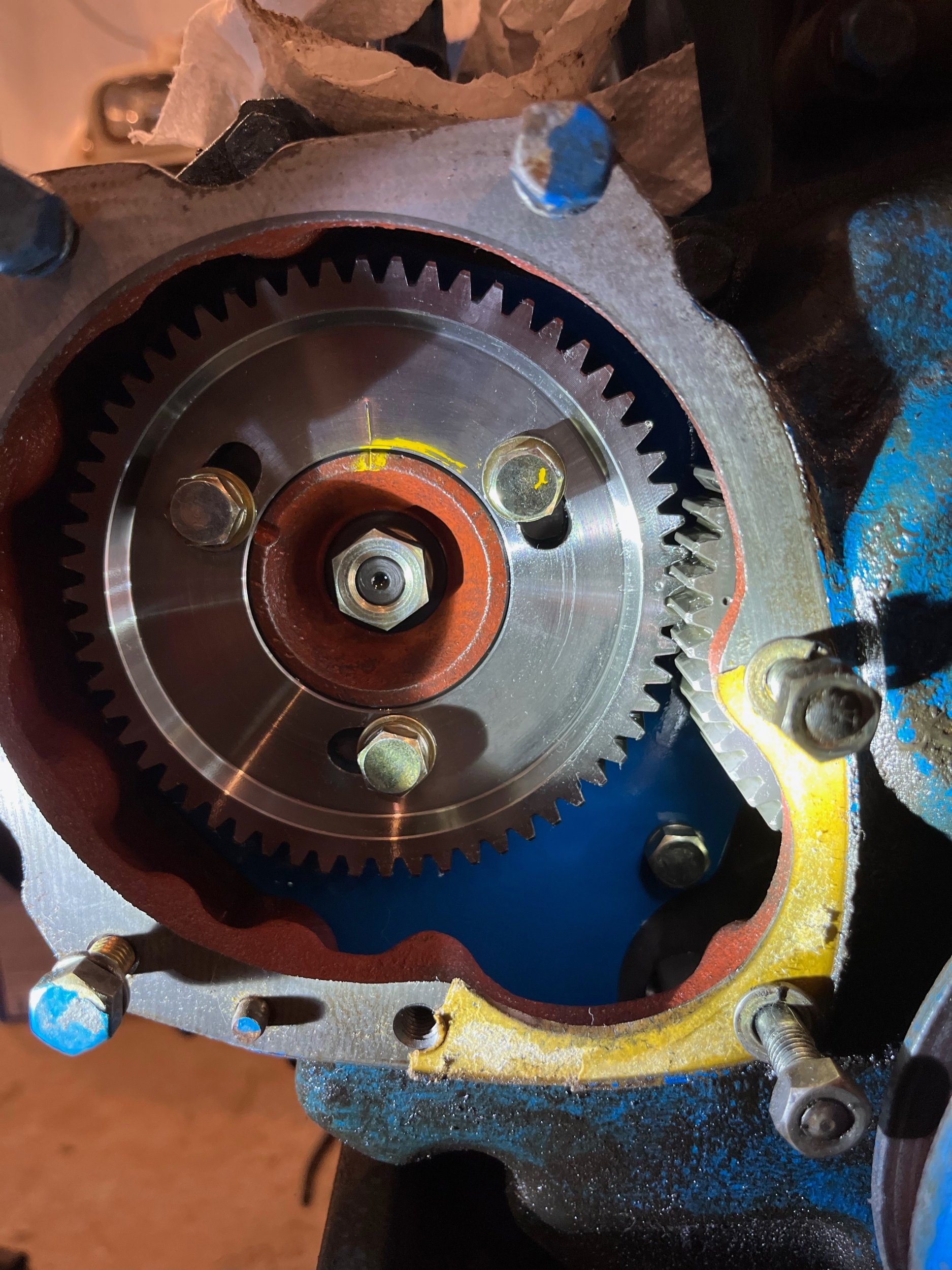

For those following along at home...
After disassembling what seemed like half the tractor, I finally got the pump gear off and got my first look at the inside-the-timing-cover side of the seal and pump shaft. As an experiment, I dried everything well, then reinstated the fuel lines and opened the fuel valve. In mere minutes, enough diesel had seeped through the seal that I felt confident that's where the problem lies. If it did this under gravity flow, under pressure it must be leaking like crazy.
I also noted some black rtv at the top of the seal, so I'm wondering if I'm not the first one in here.
Question: I'm assuming I need to pull this flange off to replace the seal. Is there a seal on this side AND the front of the pump? Or in the body of the pump on the other side? I'm assuming I still need to pull the pump and send the whole thing off, even if this seal is the culprit?
Thanks for all of the advice. It's all helpful.
Jim

   / Advice for Removing Diesel Injector Pump on 'Ford' 1910 Compact Tractor #19
Please see the manual pages in post #6
It looks like models 1500 thru 2110 should have very similar design injection pumps and there is an exploded view of pump internals included.
   / Advice for Removing Diesel Injector Pump on 'Ford' 1910 Compact Tractor #20
There ISN’T supposed to be fuel there..
The pump is oil lubricated.!!
If it’s leaking fuel there, it means that the pumping plungers are so worn out that it’s seeping past the metal to metal sealing surfaces.!!
