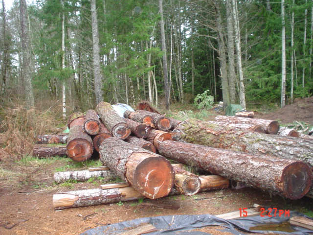

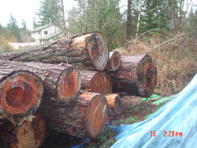

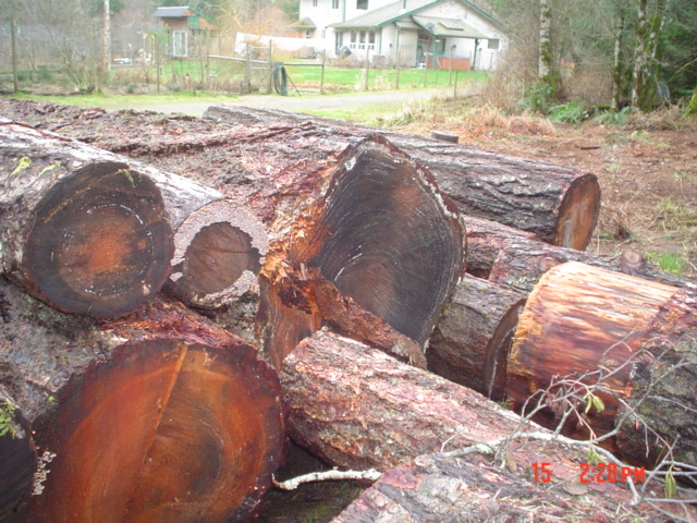

Had some large trees die on our property, large Douglas Firs over 3 ft at the butt and about 150 ft tall. Had a faller come in and cut and buck them to 10-20 foot lengths, to big for me to cut. No way was my CK35 going to haul them out. Had a cat 315 excavator come in and in 3 hours had then hauled out and stacked. Hope to have them milled this spring. Nice to be able to use your tools but also better to get the right equipment in to do it, in the long run much cheaper and safer.

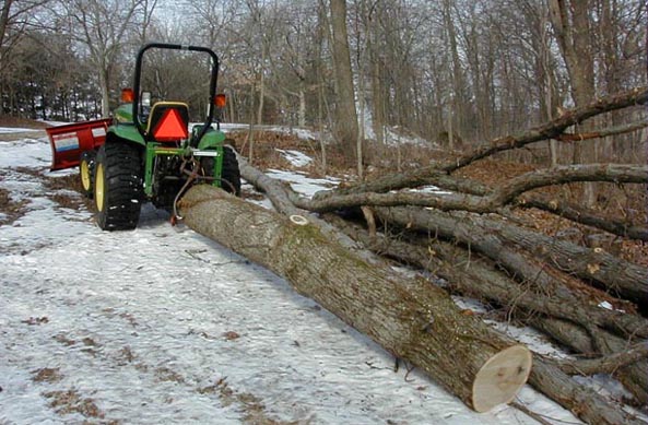

Okay I am a new Kubota L4400 owner. Here in northern Cali we recently got nailed with unusual snowfall and dropped hundreds of oaks/pines on my ranch. I have been dragging sections out with my tractor by simply chaining them up to my draw bar. Is this not a good idea?
Thanks,
Paddle Fly
I lift them up a bit on the end to decrease the resistance from the log end plowing into the dirt, and to add some weight (thus traction) to the rear wheels. Done with moderation, control, and going slow is safe.
