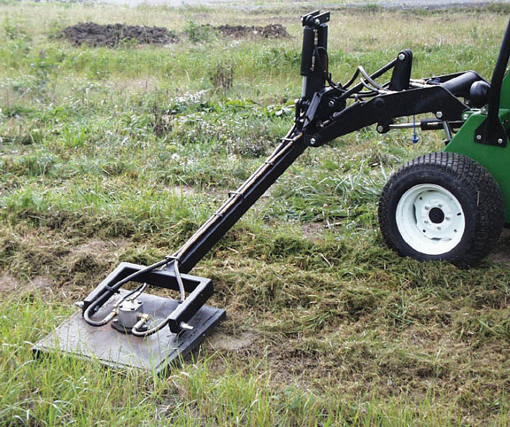

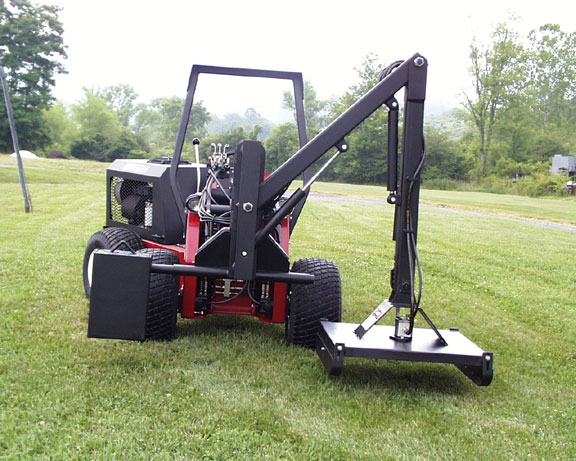

Here are a few ideas.

I will check out the offset mower options...I hadn't thought about "custom" making something.
