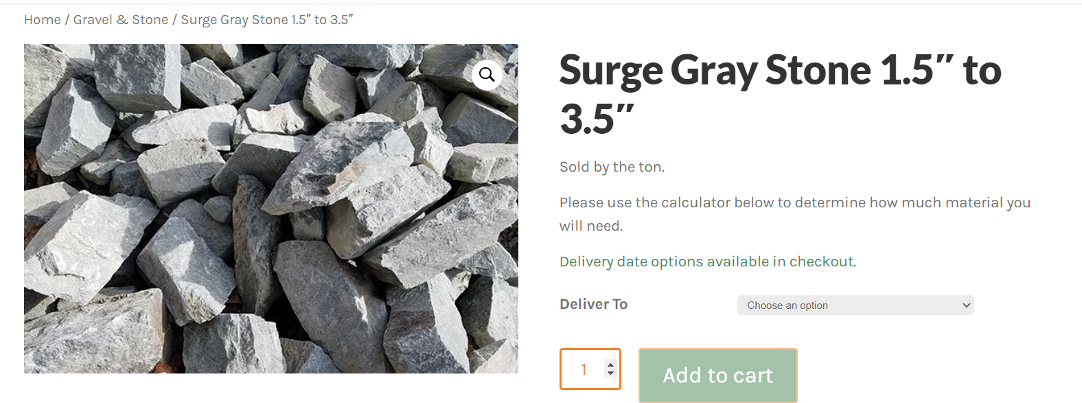

I have a road (about 275 yards) through the woods linking two sets of pasture. The road is down a steep incline that winds through the woods. I have been able to keep the water from the pasture draining into the side ditch but the road itself collects enough water to wash. Years ago I had a shale/clay mix (some call it dirt rock around here) placed on the road. The shale made a good base but overtime it broke down and washed. It broke down under the weight of equipment and the weather. I planned on topping the road with crusher run but the material hauler suggested I use surge gravel. I have a few questions: 1. How easy or hard is it to scrape surge compared to crusher run? I have a 50hp tractor so I am not concerned with the ability of the tractor, I am concerned that every time I scrape the road it will be rough. 2. Crusher run will pack relatively quickly; I assume surge will not pack solid as quickly. Will the cows be reluctant to walk across the surge gravel?
When you say scrape do you mean grading it ?
crusher run = 0.5'' to 4'' ?
I say surge stone will be easier to grade then crusher run since it has less fine to compact ... with that being said I think surge stone will always be rough, it wont compact you need fine to achieve compaction and be hell for the cow to walk on... I understand its best for erosion control but it is use for as a base.
I personally love Granular type 2 (0.1 to 4'') it compact like cement and is very hard to wash away ...
I'd say to follow you initial instinct the crusher run will give you better compaction and still give you the erosion control you are looking for or go with a mix like many brought up a base of surge stone with and cover up with a smaller diameter material.

How does the water get onto the road? Every municipal road you've been on from residential to super highways routes water off of and away from the travel surface. Spend your time, money, and effort to keep the water off the road. Crusher waste is just that; waste. It is not a paving product. Trying to get lucky and go cheap with crusher waste in a losing argument.

I think you are getting good advice, This stuff will not pack solid, but it will let water drain through it but not gather the speed necessary to move anything bot the finest materials unless you get a deluge. The company I retired from had a similar material, 2"-4" quarry spalls. We used that material dumped over raw dirt for construction roads. Mountain logging roads in northwest Washington used a blend of 2-4 and 4-8 spalls for road building.
I don't have a clue how the cows will like it, but I can't imagine a cow being reluctant to get to a new fresh grass over a familiar route. You didn't mention what you use to scrape the road, but I can imagine the occasional rock getting turned up.
