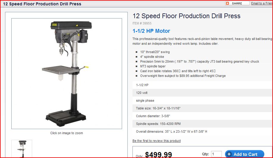

The 39955 HF DP can be bought for a bit over $300 if you wait for a sale
and use a coupon. The specs still list it at 150RPM, but that is not true....
180 is the min speed. Also, the torque is so great at that speed that you
can slip the belts, not bog the motor. I feature it with my annular cutters
here:
http://www.tractorbynet.com/forums/build-yourself/169219-annular-cutters-better-way-drill.html
