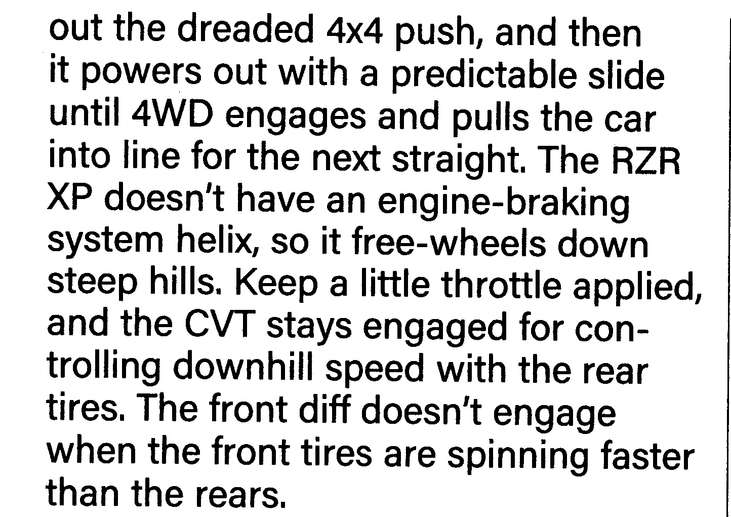

One thing I've noticed is both my ATVs and sxs's have great engine braking capabilities.
Most do. Polaris is the only one that still free wheels down hills. At least that's how the new Polaris Ranger is that the County bought for our Search and Rescue unit. And Dirt Wheels mentions that the new RZR they just tested is the same way.
Some Polaris models have engine braking, some don't.
I know my 2016 RZR 900s does have engine braking all the way to a stop.
No need to keep throttle applied to keep the clutch's engaged
