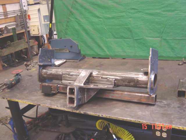

Is your hitch welded to the flatbed or is it bolted to the frame? I was wondering if there was a welding shop, or if your handy with a welder, build a custom hitch. The downside to that may be the hitch sticking out too far giving you a nice place to bang up your legs. I'm at a loss on this one...

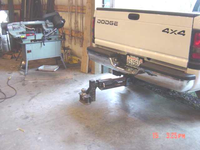

A regular pickup's width is only as wide as single wheels, normally duallies are the same and at the wheels it bumps out to cover the duallies then goes back in. The extra width at the tires is the reason they need the extra lights there so others know that the truck is wider than normal. My dodge's box is 64" (5' 4")wide, the deck on the ford is 93" (7' 9") that's 2.5' difference that could be used for turning tighter.
A longer receiver would make a difference I put a 2' extender onto my receiver and I could put the truck and trailer so they looked jack knifed but still had clearance to keep going, but with it being further out the rear end would drop a lot more causing loss of traction on the front wheels.
You seem to have analyzed the problem pretty well here. The flatbed is much wider than a regular pickup. The only solutions I see are to narrow the back corners of the flatbed by cutting them on a 45 (this will take some fabrication work). Your taillights look like standard lights which could be easily remounted to a new bracket under the bed or move the hitch further back. Any good welder could cut out your hitch and weld in a new one say a foot or so longer. I don't see how that would put more that much down pressure on the back end of the truck thereby taking weight off the front. Just readjust the WD bar tension accordingly.
Another solution would be to lose the flatbed and install a narrower dually pickup bed.
   / Advice on bad truck and trailer turning radius #27
... Any good welder could cut out your hitch and weld in a new one say a foot or so longer. I don't see how that would put more that much down pressure on the back end of the truck thereby taking weight off the front. Just readjust the WD bar tension accordingly...
You really have two interrelated problems here, the interference with the trailer and the weight distribution on the truck. The interference issue can only be solved by narrowing the body or extending the hitch. If extending the hitch causes a weight shift problem it may be that the body is just too long for the truck's wheelbase and cab-to-axle dimensions. If it can't be corrected by adjusting or changing the WD bars, then you really have no choice but to either narrow the body and don't extend the hitch, or shorten the body and use a hitch extension. Even if you could crank up the WD bars you may then end up with less than 10% on the hitch and the trailer may not tow properly.
It's hard to tell from the pics if it's a regular cab or extra/crew cab truck, but any extra cab length will make the situation worse since the hitch weight is getting further away from the front axle. Most of these 1-ton duallys work best with at most a 12 ft body, and then only in the long wheelbase version. I have a feeling this truck has significant overhang beyond the end of the factory frame. My 1-ton flatbeds have about 18" overhang and in my opinion that's about the limit unless you have the option of loading the truck light in the rear.
