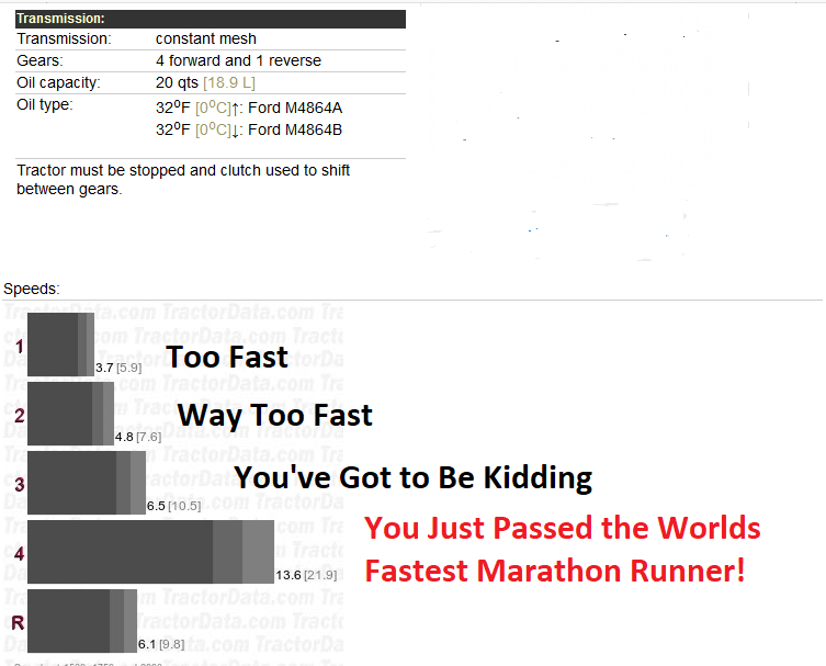

I would have added the Ford 1720/1920 to the list if they could ne purchased for $3,000.
To me, the Ford 8n has a 3 speed transmission:
Too Fast
Way Too Fast
You've Got To Be Kidding!
The 3 speed is the 9N, 8N has 4. A better option would be a Ferguson 35, has high and low range, which yields 6 gears forward and two reverse. I paid $2,000 for mine 39 years ago, you should be able to find one for around that price, keeping within your budget.
   / Advice on buying cheap tractor to grade driveway #29
Too Fast
Way Too Fast
Okay, so I left off road gear:p Would anyone want to brush hog on rough ground in any of these gears?
