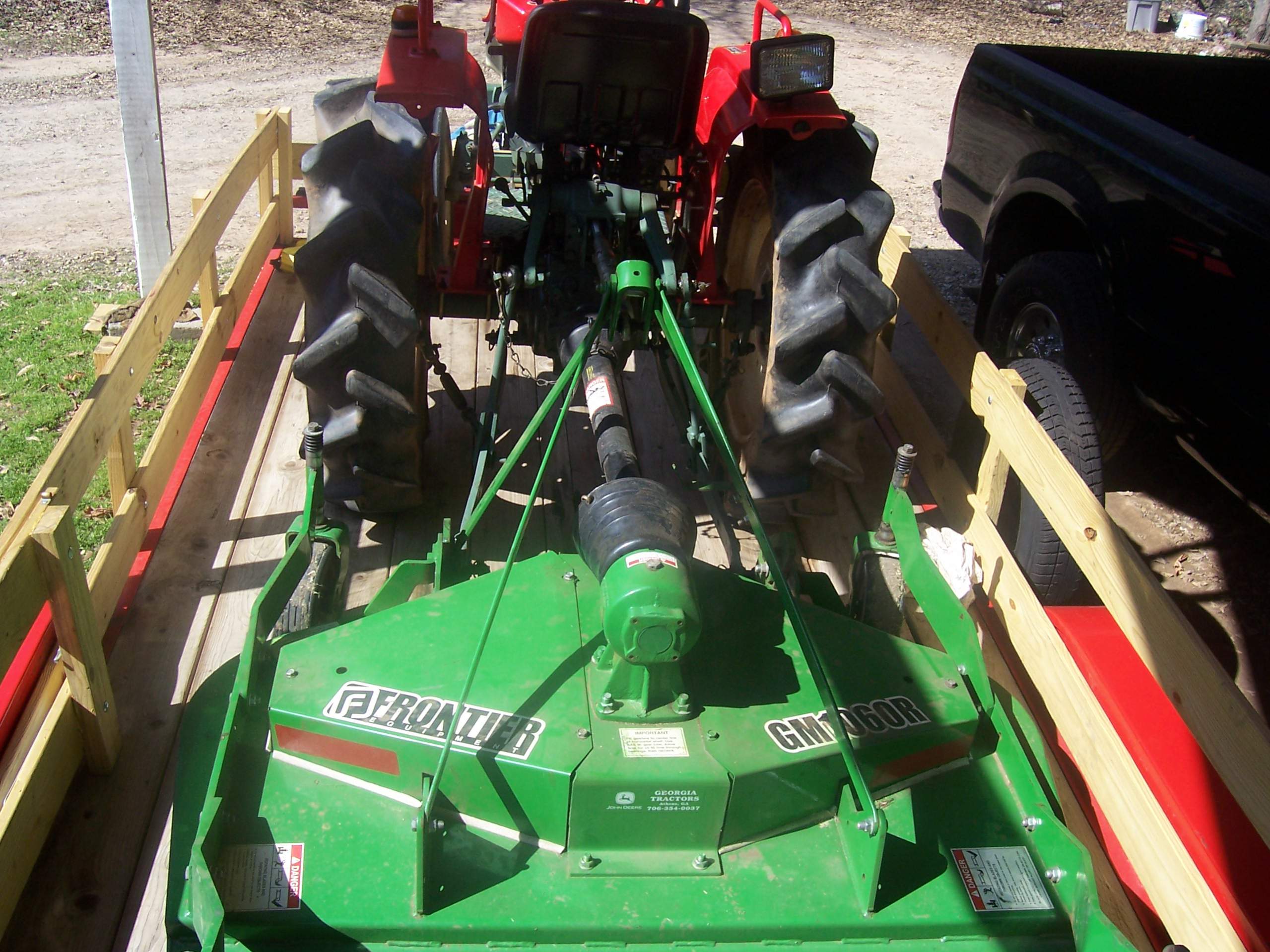

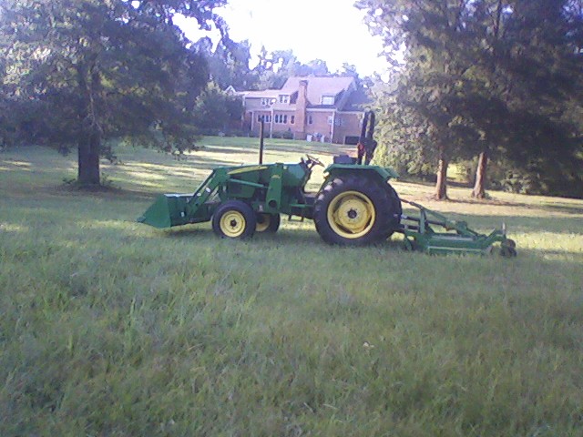

2 lots I help keep up with in Ga. 4 miles apart. Neighbors 35 acres with a JD.5103 55Hp. and my 11 acres with a Ym2000 24Hp. IMHO. look at the 2000. Bullet proof that you can get with all the options except the shifter on the dash but power shift. Cheap and easy to work on with a great parts availability. @ 24Hp.which is not much less than the 2420@27 HP. But a big price and parts difference. Fredricks. 500.00$ per Hp.?
I mostly use a 5'Frontier FM. and have a 4' BH. And rarely ever have to run much over 2100 rpms. with the FM.. I now have my 2nd. gear PTO. locking in so it's more like 16-1800rpms. Which will run all day on a gallon of fuel!!! I have "never" came close to having to run wide open throttle.
On the 2000 I don't need PS. with no FEL. and actually had to add front Ballast to the front it was extremely light when lifting them. I can turn my steering wheel easily one handed. Moving or not and I'm basically one arm and handed. The lot that it's on is Half Wooded so the mobility of it is very good. Which makes the JD. useless in my woods.
The JD has a FEL. and PS. of course but now after finding a rear scoop on CL. that works so good I highly doubt the JD. will ever have to be moved to this property that the 2000 can't handle.
The JD. has a Quick connect bucket and it stays off. No one likes it on when mowing which you can easily remove it. And some people have no business having it up there. They have already hit things with it and will easily tear stuff up when they do hit things. It was Big bucks both times!
Here's a pic of it in the back yard which also has a 60' pebble tech. pool up there. Which it was the Fence that was hit and cost Big$ to repair.....
