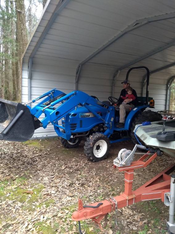

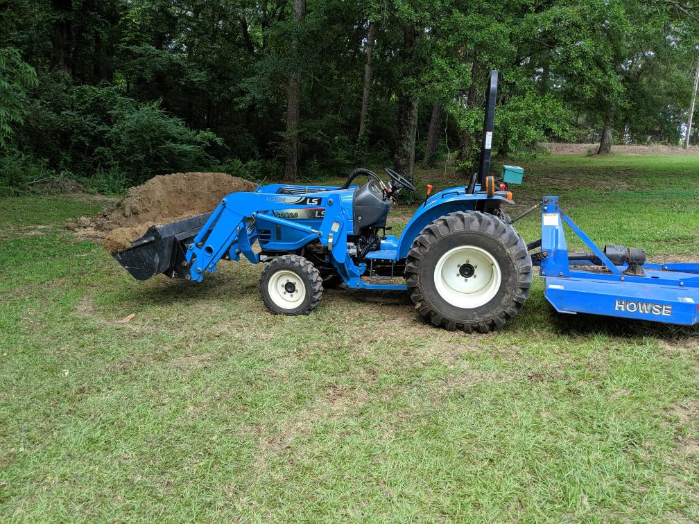

How do you like your LS? I like what I’ve read and the nearest dealer is at least 70 miles away and he’s the only one that I see anywhere around here so I haven’t seen one in person.
I'm guessing this was directed to me? I really like it. It's a G3038, which is the pre tier IV emissions version of the XG3040. It's a bare bones tractor, shuttle shift, no rear remotes or third function, no cup holders, etc. But, I needed a tractor to work and on a budget, and this fit the bill.
I bought used, so while I was looking for any tractor 30 - 40 Hp, 4x4 and with a loader, I was mostly looking for LS or Kubota. I started out looking for a new holland or Kubota, but I found out LS makes the new holland and figured I'd cut out the middle man and some cash. Those, along with John deere, are the dealers I have within 45 minutes of me, and that was a requirement since I'm no mechanic by any means. The green machine was ruled out because of the plastic hood and fenders, along with a substantial price difference even amongst used.
Like I said, I bought used, so I couldn't pass this tractor up because it didn't have luxuries. It's a solid machine that has done everything I could ask plus some (it withstood my dad's hard use...).
I test drove some of the newer LS's at the dealer, and the XR series is solid. It's got all the luxeries mine doesn't on essentially the same frame. But, if you're ok with open cab and no cup holders, the XG series can be had with an HST and you can add more hydraulic valves.
But again, I've heard good things about the Kioti line, so if the LS dealer is giving you the run around, not to mention the distance, and the kioti place is working with you and is close by, I don't think you'd regret the kioti.
