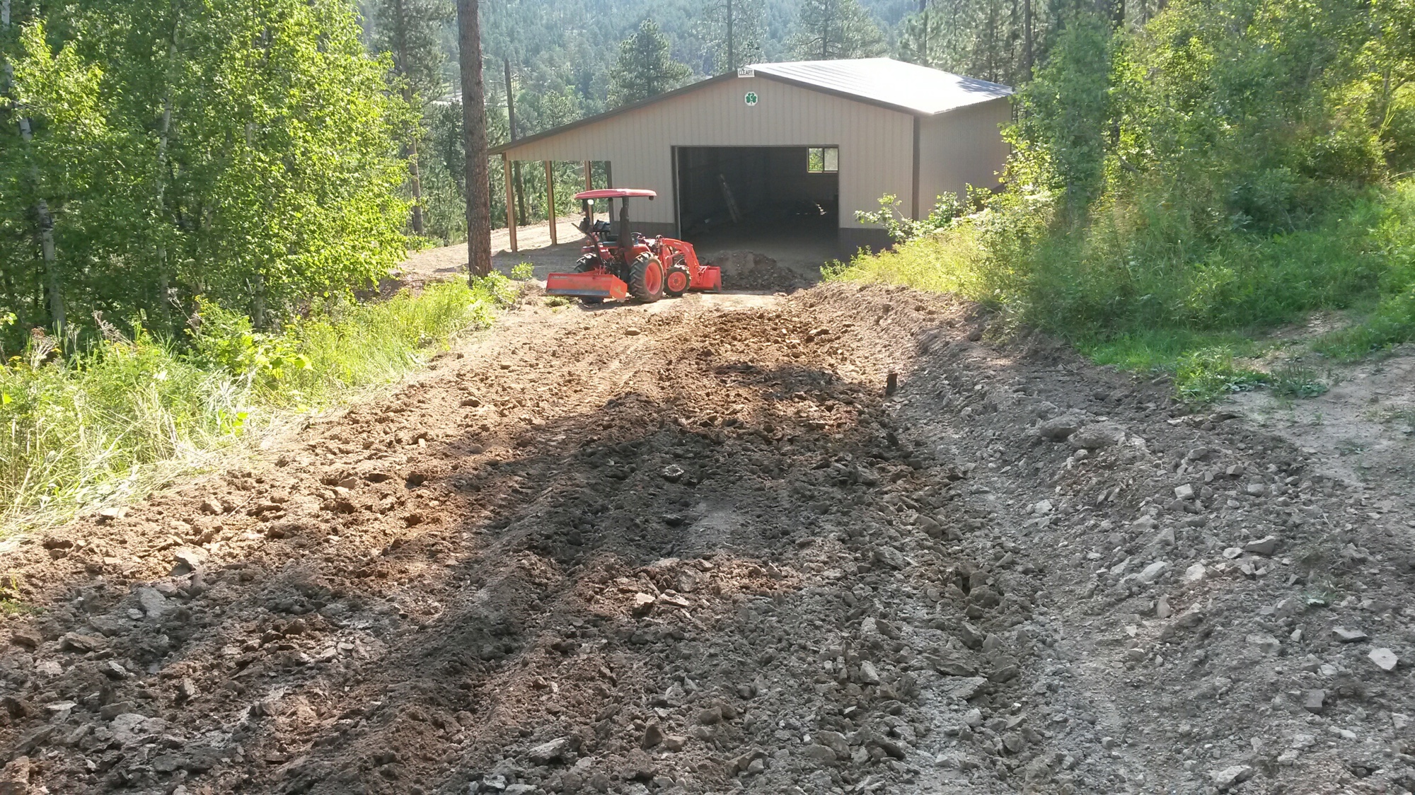

I took out the crest of this hill and deposited the material on the awning side of my newly built barn. I cut 2’ out of a 100’ section with an L2501 utilizing the box blade.
