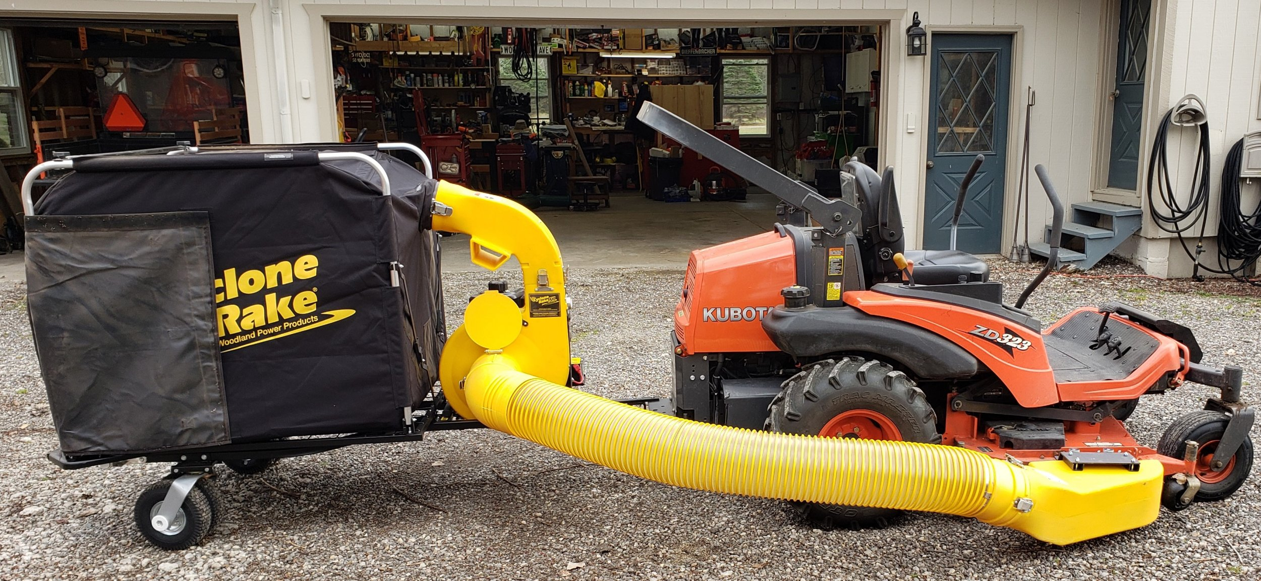

   / Advice on Lawn Vacuum for ZD Mower
I went with the Cyclone Rack. The rigid trailer mount with a well-managed deck tube was my deciding factor. Since I mow very large areas, the addition to the rear swing wasn't an issue. I did add a 45 degree elbow off the exhaust port to divert the exhaust away from the CR's engine. Other than that, it was a textbook install.
   / Advice on Lawn Vacuum for ZD Mower #6
How much flex do you get in that hose? Looks like right hand turns only.
The Cyclone Rack attachment does not articulate, it remains parallel to the ZT, there is no flex in the deck hose.
   / Advice on Lawn Vacuum for ZD Mower #8
Good choice. Looks great. I didn't know they came in yellow.
