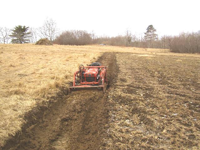

We have very similar tractors. Mine is a Kubota B7100. It also seems we have all the same problems.:D
You want to pile up several loose buckets of dirt and practice loading on those. It takes practice to coordinate the hydro pedal and the joystick actions. Someday I'm thinking I may learn this too!:p
Many times using only a corner of the bucket to loosen material will work toward getting enough for a full bucket. You may also try and back drag dirt off of a pile to make loading easier.
Don't worry about the tires. You will be able to spin any you put on.
For limiting the drop on the three point you may wish to use the retaining chain.
I like keeping the throttle set at about three quarters or more open for loader work. This gives you lots of circulation so the hydraulics are responsive.
Enclosed a picture of where I have removed dirt. This is just for example purposes and can give you an idea of what can be done.:)
In the first one the area shown has all been excavated down by the tractor in the picture. The second picture is a trench in the making.
