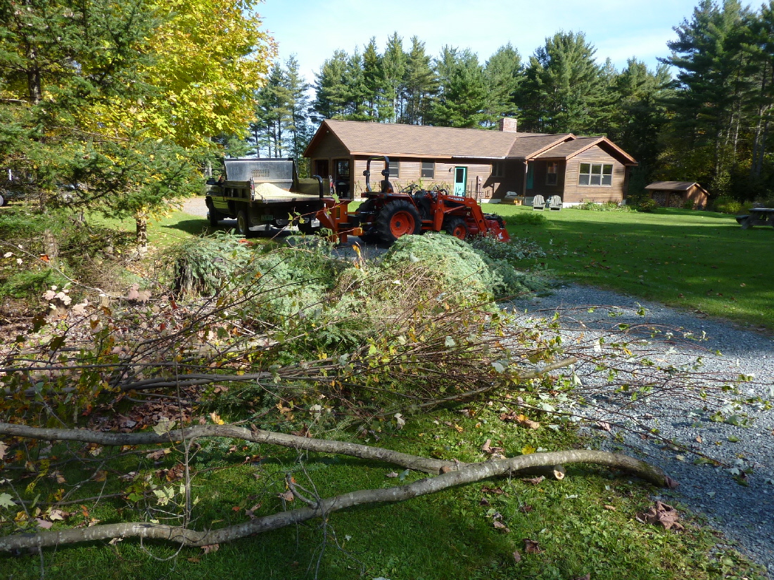

These are some great points. The only time I get frustrated with my manual feed Wallenstein is when sending in a really twisted branch or one with a lot of side branches at large angles. Maples and Beeches tend to be like this. It can take a lot of twisting and coercion to get them to feed. I keep a pair of loppers handy and if a branch is especially gangly I will lop off the side branches ahead of time to try and streamline the shape. I shove them all in at the same time, so still chipping the same amount of stuff, it just feeds better.
In contrast, if I send in the top of a pine tree, everything 4" or less, the shape of the treetop is such that it just gets sucked in and chips like magic. Saplings behave the same way. It's really just the gangly maple and beech branches that turn into a wrestling match.
