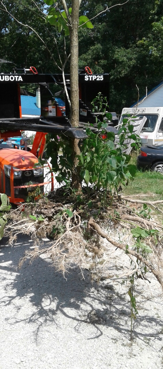

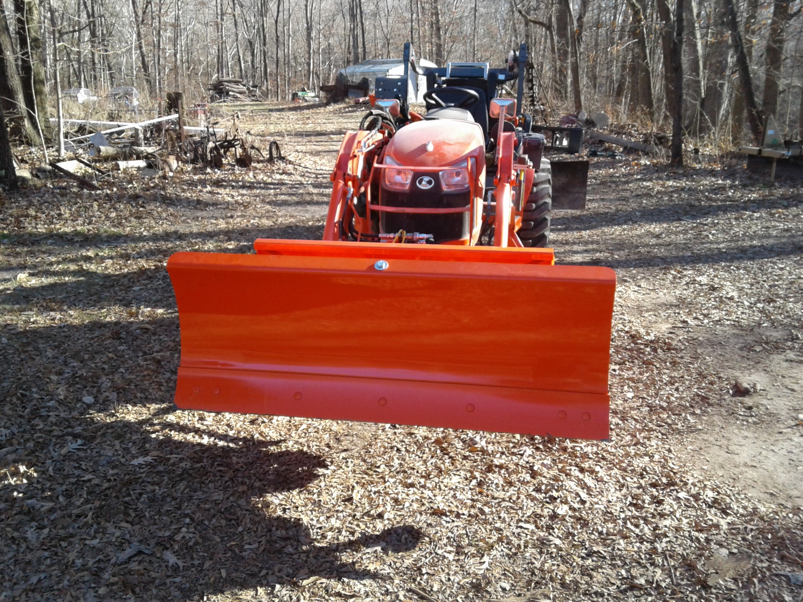

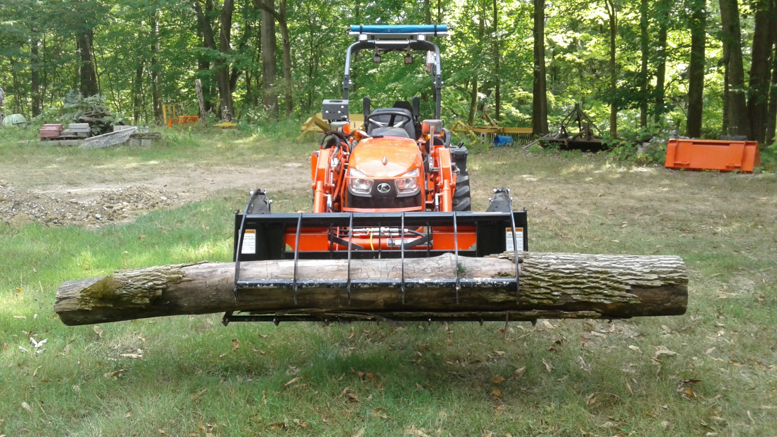

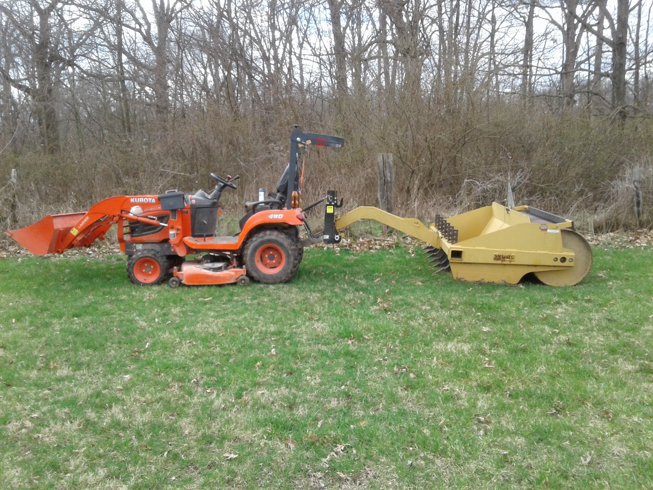

Gear driven is best for ground work, food plots, "Big AG". Hydrostat best for loader work, frequent direction changes, and frequent ground speed changes. You will need the 3rd function added to FEL for the grapple. The B2650 can have up to 3 rear remotes, wish I ordered them (have single remote) did not know about 'top and tilt' 3PT setups. You'll eventually want a box blade and the hydraulic top link makes this attachment truly functional. If you have rear wheels loaded it's better/safer for loader work. You may want something smaller for lawn work.
