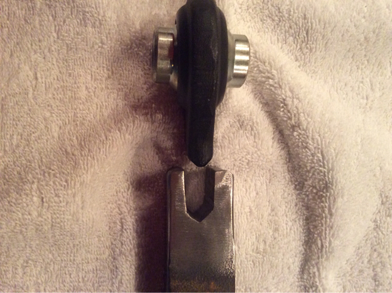

It will be stronger than original they way you have it as long as you get a decent weld. You could even preheat it with a small propane torch like is used to solder copper pipe. The eyes are made to weld on. I would lean toward using 7018 since MIG for a beginner can be deceiving if it has proper fusion and penetration. 1/8" 7018 at around 130 amps all around will be more than strong enough.
That's exactly what I did. Ran the 1/8 at about 125. I'm trying to learn on things that aren't critical and ugly doesn't matter!
   / Advice on welding link repair #12
Broke the ball link on my telescopic stabilizer.
433556-advice-welding-link-repair-image-2114241716-jpg
That Ball end could have been simply beveled out and welded back on, and been strong as original. With a good weld. The way you fitted the replacement part makes the repair pretty much independent of the weld quality. A very good way to do it if you are unsure of your welding ability (for now). Plus you re-newed the ball.
From the wear marks on the arm it looks like that ball end took a lot of side force from some implement that didn't fit properly - which probably cracked the original weld. And if that implement is no longer used, (or fitted better) it shouldn't crack again.
I can tell you took pride in the tight fitment, but I would have recommended to bevel out your tight slot a bit, it would weld up easier.
Fellas recommending to pre-heat,,,,, Can anyone explain what would be the difference betw a preheated repair and one that was simply welded?
But it's all done and I'm sure with that forged unit it's stronger than the original construction.

Preheating on carbon steel helps to remove moisture on the metal that can cause hydrogen embrittlement and porosity in the weld both of which are detrimental to a good weld. It doesn't take much preheat to do what needs to be done.

OK thx. I've dried stuff (prior to welding) that was visibly wet but never heated a dry part to dry it further.

Wait until you start playing with T1, or AR-500, AR-400, so on, and so on! Preheat, and post heat make or break you.;)

Good reminder for the case if you are welding heat-treatable steels. I bet this fella's lift arm is mild steel though, which will have no effect in that regard.
I suppose preheat could make a little better weld, and might look nicer too. Which is often a benefit, especially when the repair is out there visible! If the torch is there and you have the time for preheat. It's interesting to discuss too. :cool:
