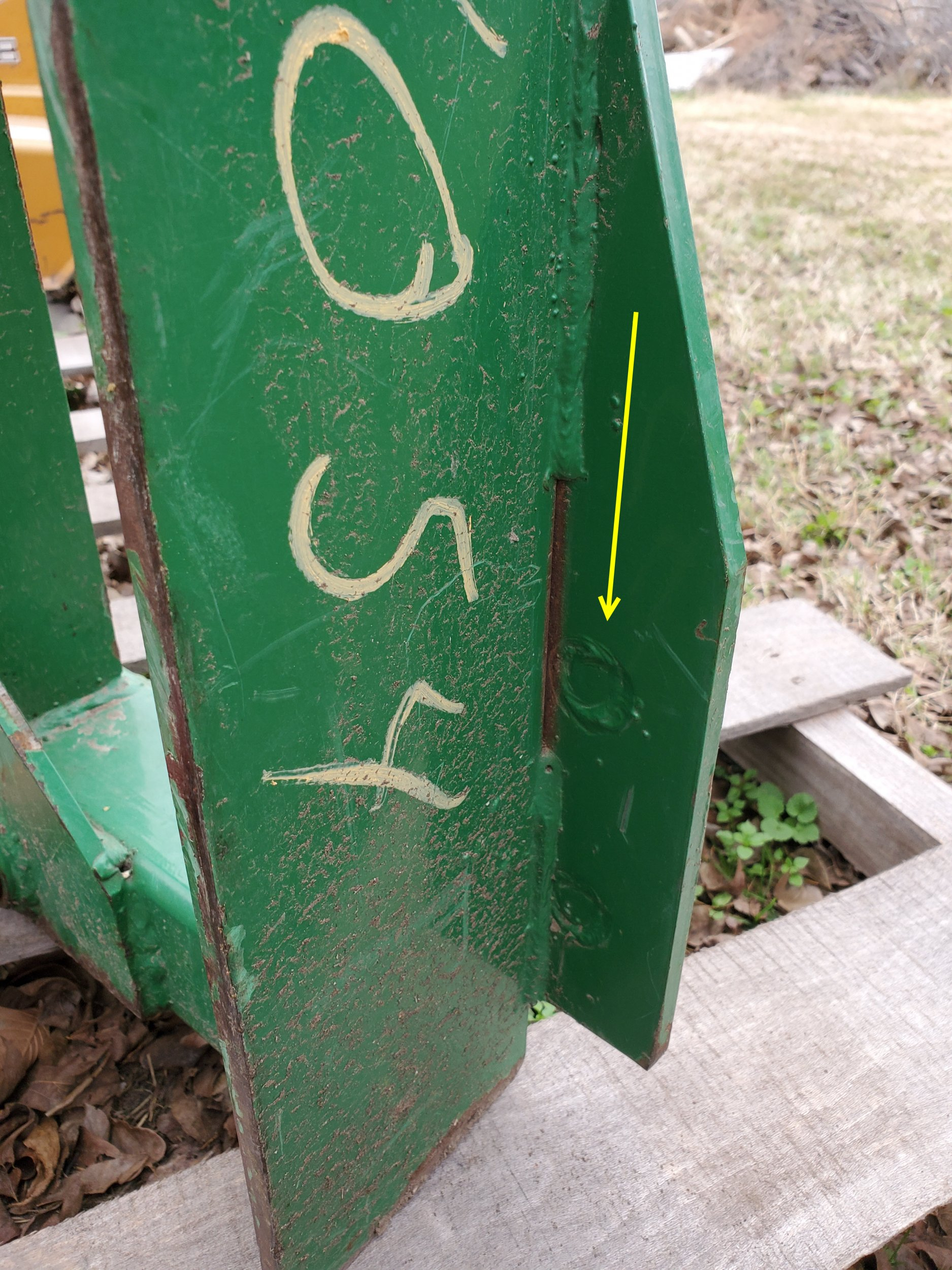

I'm using a JD 300E loader with the quick attach bucket ... The pin on this side was cut off by the previous owner. I suspect to get it to fit a different setup.

I'm a little confused as to why grinding the weld away failed. There should be plenty of room there to use a 6" or 4" grinder and get the weld out of the way. As far as cutting too much material away, you won't, mainly because those pins don't carry any pull out force unless you curl the spear into the ground.
   / Advice Please On Removing JD Quick Attach Pin
#19
I ground on the weld all around the circumference of the pin more than an 1/8 inch deep and never started to get a separation of the pin from the weld. Never saw a "crack" form.

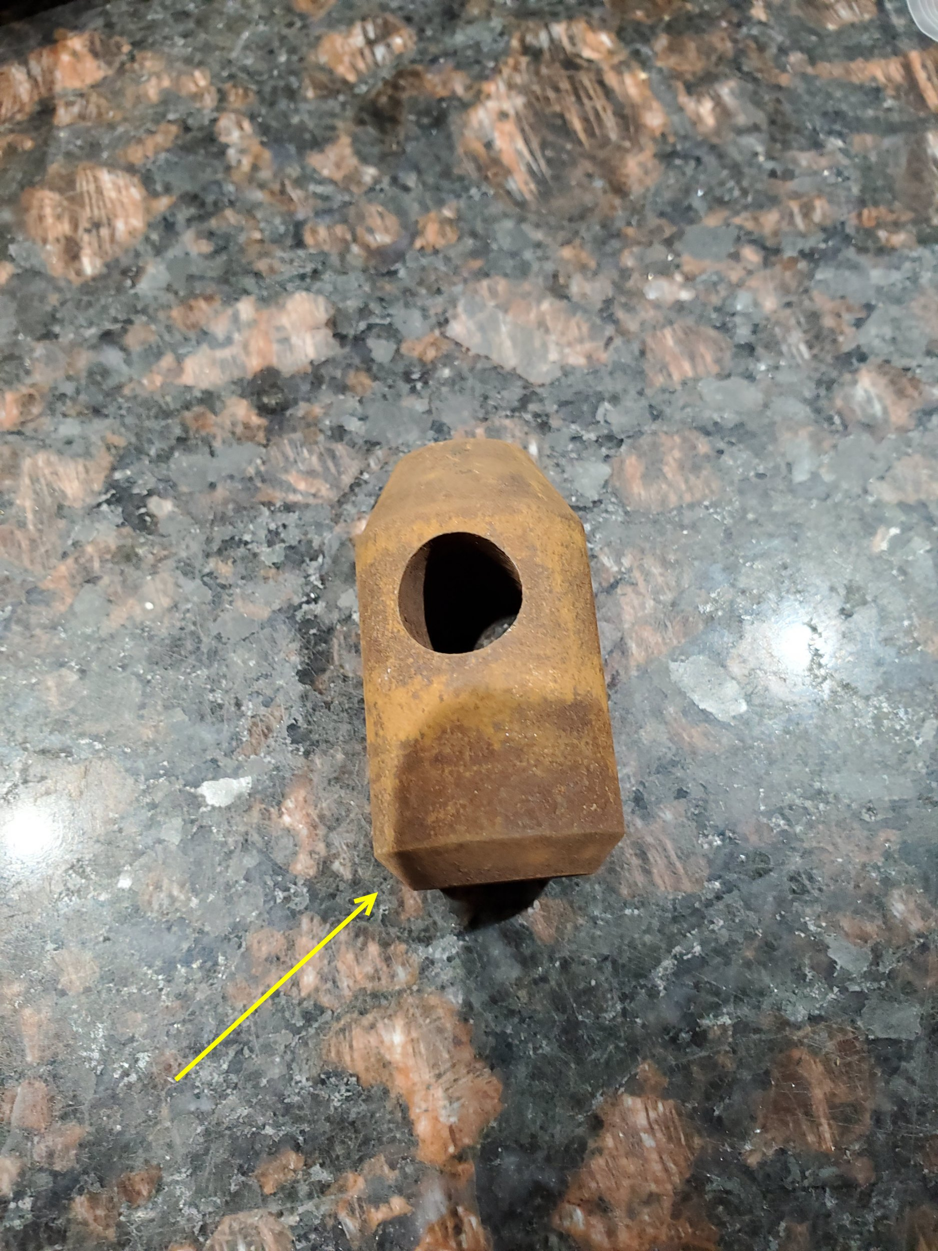

The "weld" end of the pin is beveled so you more weld inside the hole than on the flat surface and that means the weld penetrates about half the thickness of the plate.
The main thing is the weld is flush with the surface of the plate the pin is welded into. In order to grind the weld off you're going to make a sizable hole in the back side of the plate by grinding away a lot of the surrounding metal. This is something I'd rather not do.
I think by cutting out the center of the pin, drilling small holes as suggested, I can then break out the remaining edge pieces and then use a cylindrical grinding stone to clean out the hole until the new pin fits correctly.
I do appreciate all suggestions!

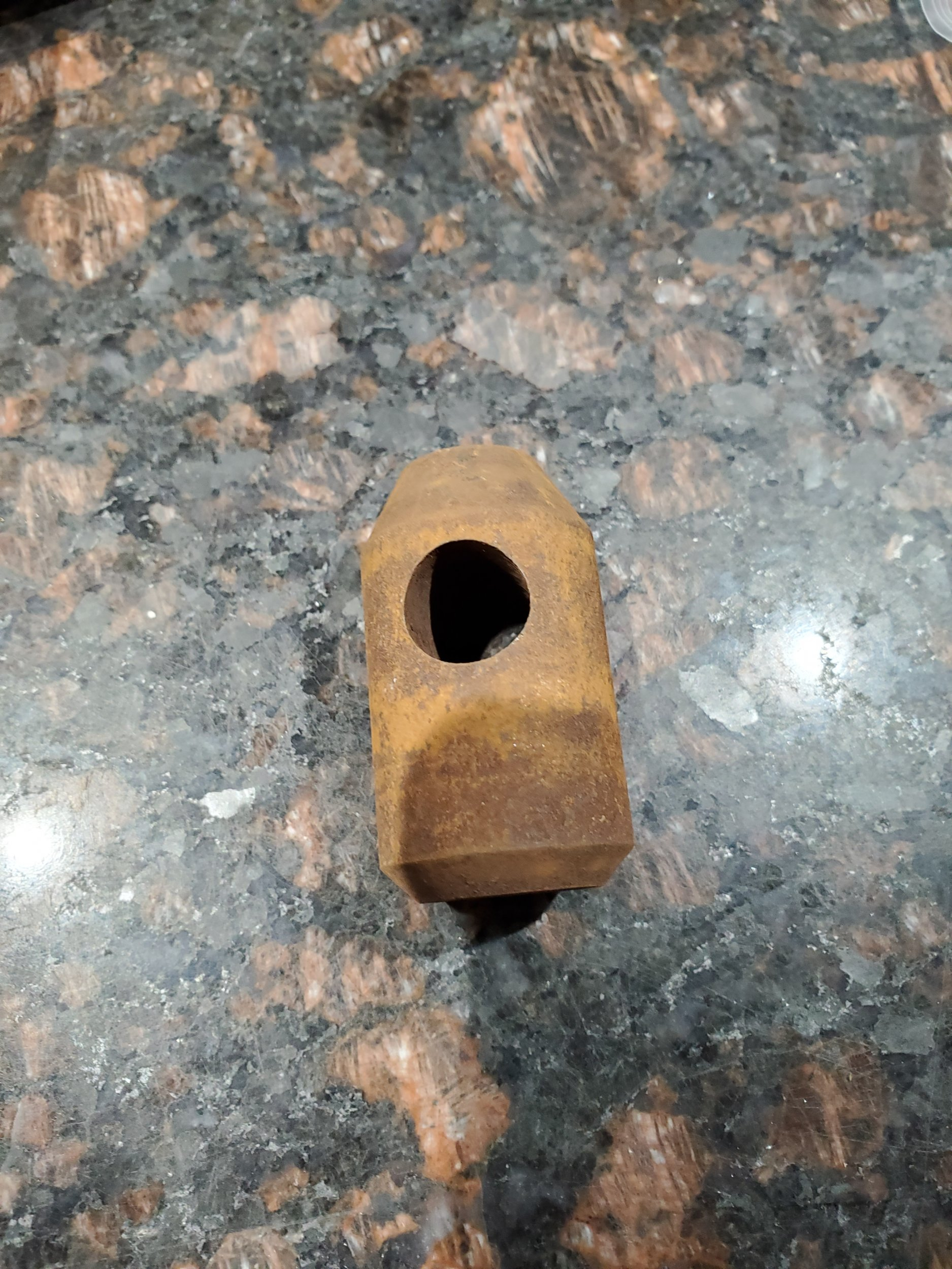

Here are the pictures again and one pointing to the bevel on the pin for welding.
