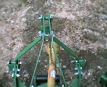

I may be wrong but my 1060E was not "I-MATCH COMPATIBLE" w/o the conversion kit. I believe the 1072E, unless a very recent updated version, also requires the conversion kit. The "Conversion Kit" instructions list the 1072E, 1060E, and 1042E as the mowers requiring this kit. The driveline that should come with it should be long enough to deal with the added distance the I-Match pushes the mower back but the kit is necessary.
If you go with that mower, make sure you get the kit (if needed as suspected), know what it's going to cost you, and have the dealer install it and pick it up with the I-Match when they deliver it. If, as I suspect, it is not a great fit, the dealer can see that right then and there. I've attached one pic that shows the "skew" of the swing arm to rear support arms. I got "most" of that skew out but it is still not what I'd like!

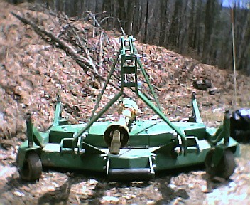

I forgot to mention you probably want that "Anti-Scalping" roller too. It really does keep that pointed front edge from scalping off high spots on a lawn.
Also, I wrote 1042E where I meant 1048E.
Here's a front pic of the 1060E with the kit and roller. Sorry it's not a better pic.
Tom

So what exactly does the kit consist of? Would you mind taking a couple of close-up pics? I too have made the I-Match mistake (1072E RFM).

Thanks for the reference to the thread - found it! Wow... there's a lot to that kit.
In the thread there was mention of simply hooking a chain to the top link - sounds straightforward. I'll tinker and let you guys know what I end up with. The old Millermatic may be called into action...
