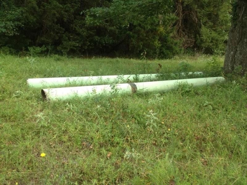

About 3 years ago I hired a gentleman with a mulching machine to cut a 15 ft "firebreak" around the perimeter of my property. I have since conducted 3 prescribed burns for wildlife habitat improvement. The perimeter road is crossed by several little draws or creeks. Several cannot be crossed with a tractor and 3 pt shredder and therefore I cannot keep them maintained. I want to use pipe like is pictured below for culverts. Any and all advice welcomed.
Cover with rock, dirt, both? If both, which first?

from pictures it looks like that piping is for "air ducts" in some building. *shakes head no* that stuff going to rust out quickly!!!
you can goto menards, lowes, home depot. and pick up some single or more likely prefered double wall culvert pipe, 20 foot lengths fairly cheaply. and would most likely be plastic, and last a long time!!! cost of rock i would imagine going to eat up some cash, and having to redo it in a few years due to pipe rusted out...

Thanks guys. This pipe was advertised locally. I'm going to look at it today or tomorrow. It is supposed to be 12" diameter 1/4" wall thickness natural gas pipe.

The pipe in the picture is too small for any creek or draw. It will clog with debris with any significant rain
