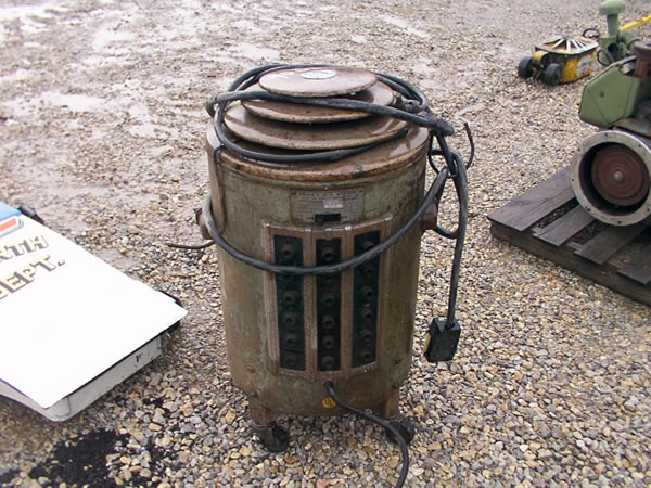

We never ground off rust when welding here on the farm...
No failures yet but that is the correct procedure...
We used 1/8 and 3/16 rod here on implements and set the welder at 75 to 85...
Our old AO Smith welder did a good job but it sent out sparks that would put 4th of July fireworks to shame...
Think is was a 20-18...
It was a horse...
