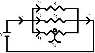

Lets look at some simple facts: Electricity takes the path of the least electrical resistance. Paint is a poor conductor. Rust is oxidized metal which is also a poor conductor compared to clean metal. Paint burns. Burning paint contains a host of chemicals that are not condusive to the chemistry of welding. And lastly, what is stronger at holding 2 pieces of steel together when one of those pieces is sheet metal, a bolt with a large washer or a weld?
More accurately, electricity will take ALL paths available. An important fact to remember when dealing with ground wires.
