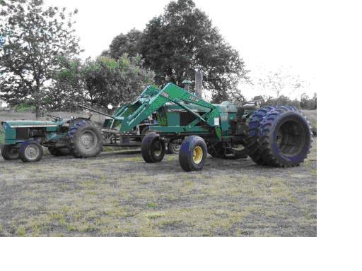

Yes, the two shafts on the 4320 are 540 and 1000RPM. Turbo - Yes there are some things it adds to the overall package. Mainly, I don't like cranking up and immediatley using anything w/ a turbo. Same for shutdown, it needs to idle to cool the turbo after a good workout. Also, if it has a turbo, I hate cranking it up for 10-15 minutes of work. If I crank a turboed tractor (especially in this HP range) I like to use it all day. And it will idle through lunch. With the project you have ahead of you, I don't think that will be a problem.
Also, we bought a FEL for our 4320 from EZEEON .
It works great for tossing around 6x6 round bales and emptying 2000# bags of creep feed into the feeders. But I will caution, a lot of the older tractors didn't have the front axles really built for loaders. And our 4320 is one of those. We put 14" wide wheels and aircraft tires on the front.
I think I attached a pic of it w/ my Brother in Law's 1020 for reference
