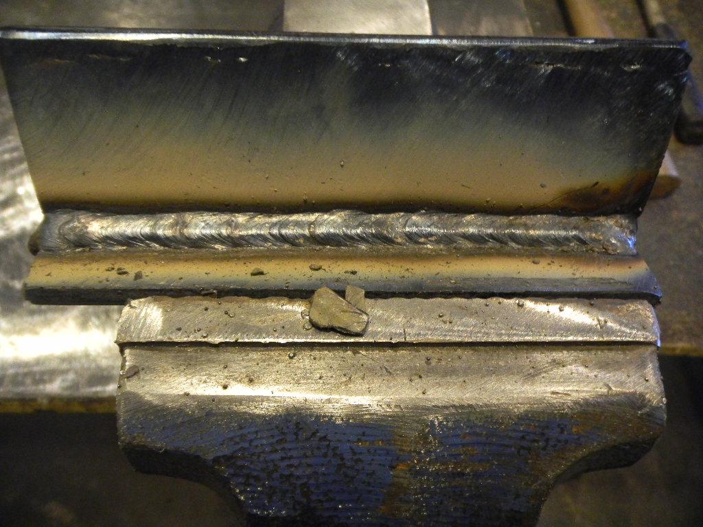

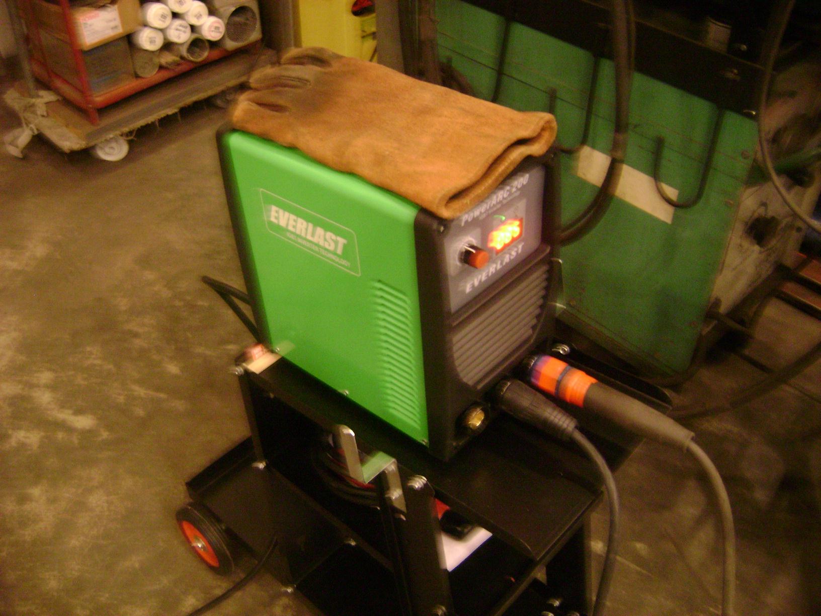

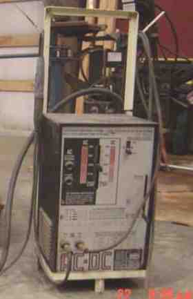

These inverters amaze me. 7018 welds made with a buzz box, and the Everlast PowerArc 200.
   / Advise for a first time Welder #47
That is not a Home Depot buzz box. I gather that my concept of the buzz box just being the cheapest stick welders sold by Lincoln and Miller and virtually never used professionally (anymore) is wrong then.
   / Advise for a first time Welder #48
That is a Montgomery Wards welder, bought new in the 1970s. Pretty much bottom of the line if you ask me.
   / Advise for a first time Welder #49
Do you consider a Lincoln IdealArc to be a "buzz box" or is that term reserved for the bottom of the line equipment??
   / Advise for a first time Welder #50
No, I wouldn't. I'd consider an IdealArc a low end to mid range commercial welder. The term buzz box means to me something that the uninformed home owner would buy.
