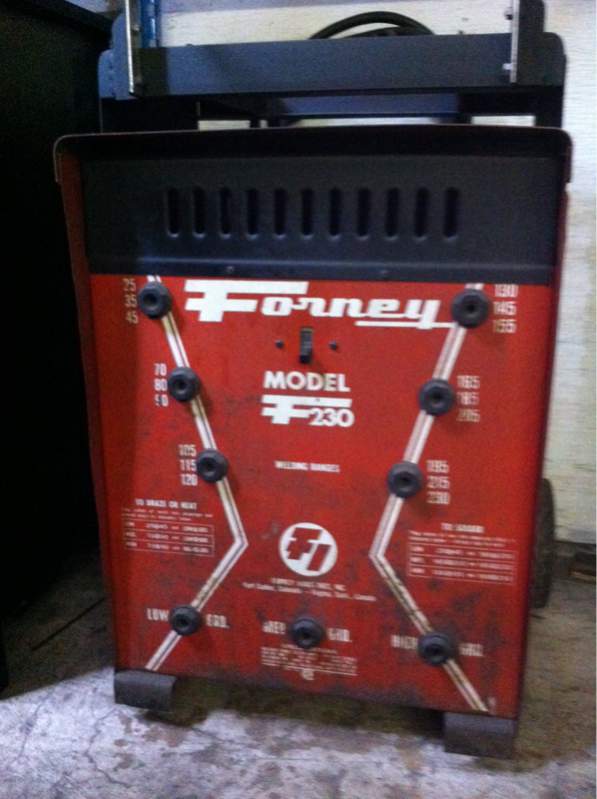

Sorry. Don't know what I did wrong. Will try again
Terry
   / Advise for a first time Welder #78
Looks to me like a simple tap selector buzz box.
   / Advise for a first time Welder #80
Okay. Thanks. Had machine since new(1966) and never even heard the term 'buzz box' til I joined these forums. The sheltered life of a farm boy LOL
