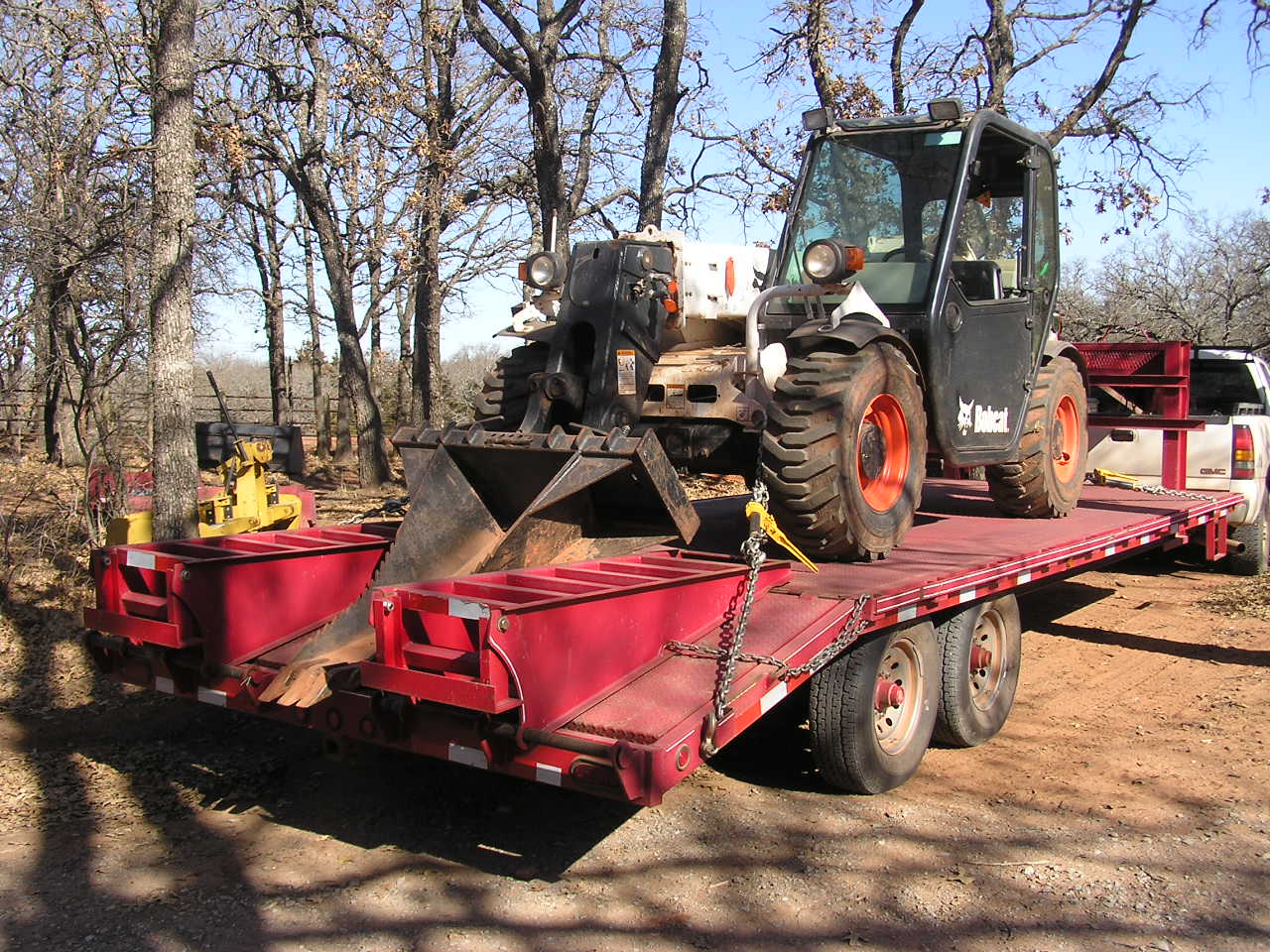

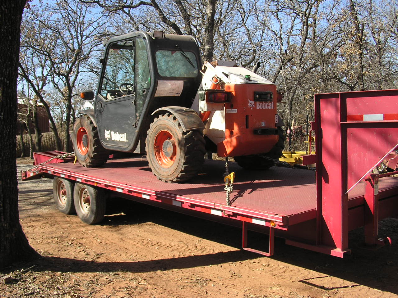

I tow my Versahandler backwards to protect the windshield.
4 short 3/8" grade 70 chains and 4 ratcheting binders.
And a strap across the bucket if traveling on the highways. :D
