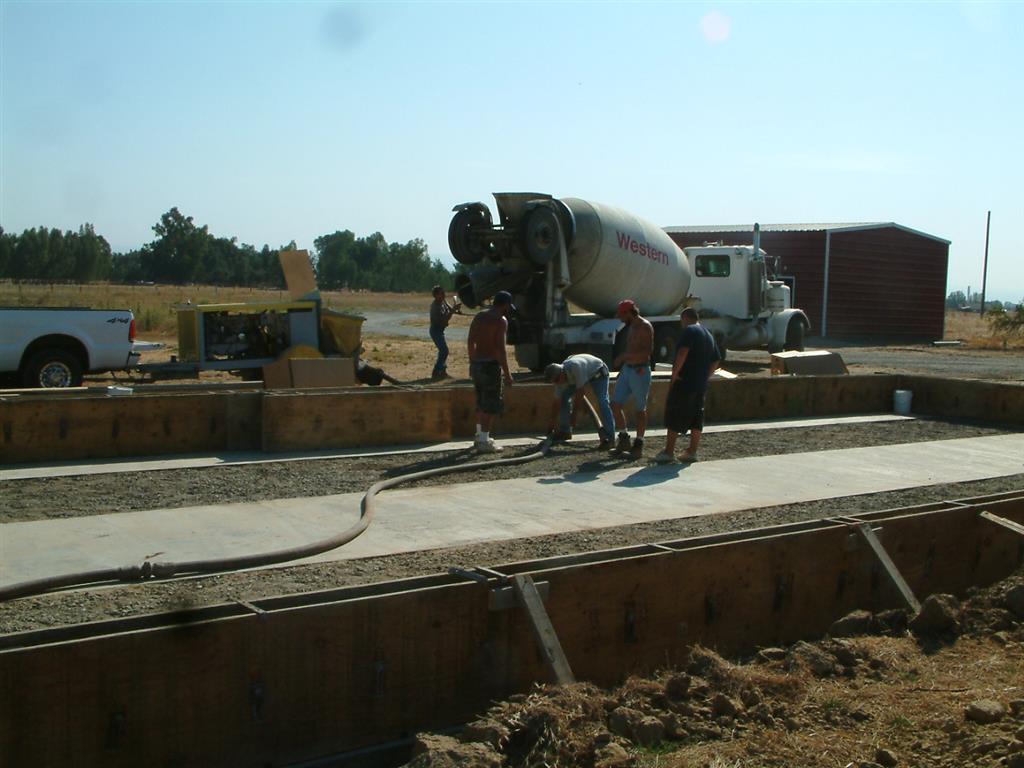

I just heard back from them. The price does not include gravel. Apparently they were planning on pouring straight onto the dirt!..
That's how millions and millions of homes are poured; but if I'm in a non freezing area. Visqueen is required by building departments, but it's actual usefulness is up for (lengthy) debate.
/ advise please: difficult workshop build #43
For a garage that size on a slab, it's probably fine if it is good solid ground (I would take the top soil off and get to something solid). I remember helping my dad pour a 30x44 garage floor like that 25+ years ago. It's still there with no issues.
/ advise please: difficult workshop build #44
Like posted above you don't need to add gravel if your on virgin soil and have removed the organic matter (grass/topsoil). The only reason i needed to add 2 loads of process was because i had to dig down in order to remove the organic matter. The slab would of been below grade had i not added material. As far as you being worried about them pumping or not i wouldn't worry as long as they don't hit you with an "extra" after the fact. They should know if the mixer will fit or not.
/ advise please: difficult workshop build #45
I worked industrial construction for 40+ years and all concrete was poured on to virgin soil, no rock. This is in compliance with ACI 318 Code for Concrete construction.
If in a water seepage area, then sometimes a "mud slab" about 2" thick was poured onto virgin soil for workers to walk on and not muck up the mud. They put their rebar in using 3" square x2" thick concrete rebar supports that we made on site with 4000 PSI mix concrete. The plastic store bought ones work OK also.
UP North in Canada, when a slab was put in above the frost line (this was almost all as the frost line was 13 feet minimum) the concrete was places on high density foam to allow the ground to heave a bit without affecting the slab.

I'm working on getting help to do the pour. Will also have the concrete supplier take a look to see what kind of equipment he can get in. Especially since I may end up moving the location some due to the slope.

I would do the excavation and forms and pay for the job unless I could get a couple guys to help me. Even if I had to pay them.
Someone will come on and post that the mesh is worthless because they will walk on it and push it to the bottom. But I think you can tell them you don't want that to happen. They can pull it up with hooks on their come along as they place the concrete. If they do that you'll be ok.
Then I'll be the one, mesh is worthless for more reasons than stated above.
/ advise please: difficult workshop build #51
I've demo'd a lot of concrete driveways over the years. The ones with wire take a lot more work to break up then ones with out. When you run across a driveway poured right; 3000 psi, wire, 6" thick, well compacted ground underneath; poured at a reasonable slump; they are very difficult to break up with a back hoe.
