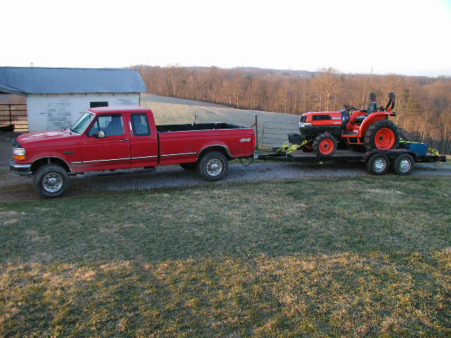

Well your needs are similar to what I needed in a tractor. I have about ten acres and most is in pasture for the two hay burners (horses) we have. I needed something to mow the field with and maintain the driveway. I wanted something large enough to be able to do those tasks with ease and comfort. I chose the Kubota L3130HST. The tractor is large enough to have a smooth enough ride I could mow at a pretty could speed and has plenty of power to run the 60" brush hog. But the tractor is small enough to get into tight areas and not to large to worry about hauling the beast when needed. I could not justify the FEL....even though I would have loved it... I have used a post hole digger a few times and the tractor works great for that. The HST trany is the next best thing I did choose. It is smooth and a pleasure to operate. While mowing I can change speeds and direction in a snap. If you do get the FEL the HST really stands out and I am sure most would agree. I highly recomend this tractor! Now go out and put your backside on a few machines and you will really start to get a feeling for what you like and do not. Do not beg a dealer to take your money....there are plenty of great dealers out there that will work hard for your cash. Have fun and we will all be here to help spend that cash and answer questions.
Rob
P.S. I have posted a pic of one of my hauling days. We were off to our church for some landscaping. I used a 6' box blade and had a great time working the dirt.
