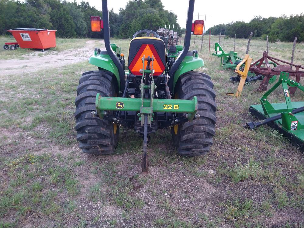

Darryle, if you used a straight shank subsoiler over the curved shank subsoiler might solve your issue. Straight shank does not upset the soil the same. I have one and it leaves a slight uplift. You probably could have a straight shank made to use the frame you now have.
I have a straight shank, it's to the right of the tractor in this picture, it is horribly disturbing, actually worse than the parabolic ripper. I had a Rome 5 shank parabolic that I used when we raised peanuts. I prefer the parabolic style since they have a tendency to pull deeper, although they are also harder to pull than the straight shank.
The problem is that this is black land soil and it is tight and tough, hasn't been worked in more than 30yrs, so either style severely upsets the soil.
My goal is to subsoil every few years and aerate every fall and spring, possibly summer if we have an extended drought, especially if the forecast calls for rain. The spring and fall aerating are solely for helping wildflower overseeding for the honey bees.
Good thing is, if the blade style doesn't work well for me, I can always buy 5" wide AR plate and cut and weld them parallel to the centerline of the other tank. My fear is that that style takes more horsepower to pull and I don't know that my little tractor will handle it.
